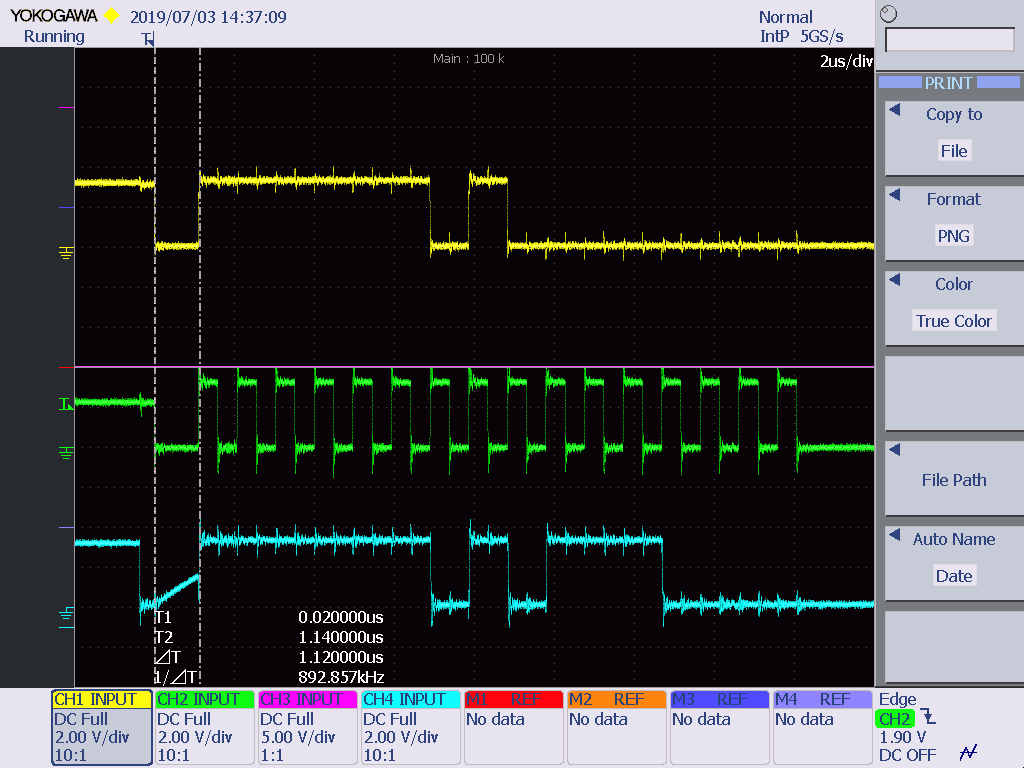

I am facing the problem that MibSPI does not capture Rx data into SPIBUF.
I use SPI mode as a master device, and execute readout operation of slave device (CAN transceiver) ID register.
When observing each signal of SCLK, MOSI and MISO with an oscilloscope, it is expected waveform .
However, capturing to SPIBUF is not performed.
RXEMPTY changes from 1 to 0. However, the data is All 0.

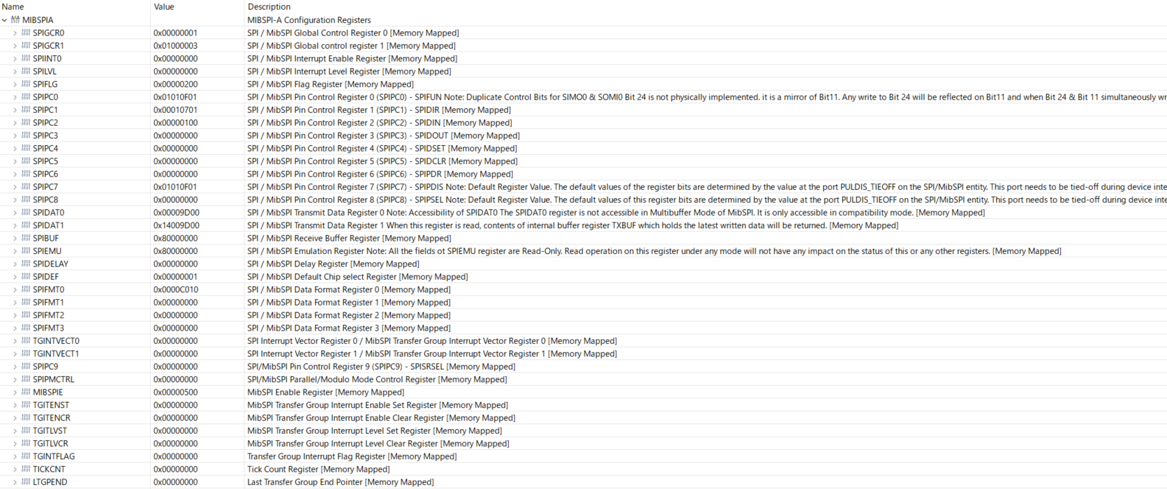

I attach a waveform and a register dump.
The waveforms are MOSI, SCLK and MISO from the top signal.
Are there any restrictions?

  • Hi Vivek,
    I use NXP TJA1145 as a CAN transceiver, and configure SCLK=1MHz, use MISO, MOSI, CS.
    SPI mode is used on AWR1843.
    The waveform I attached shows the MISO data is outputted correctly, but the data does not come into RXBUF.

  • Hi Raghu,
    I tried to use the SPIA and SPIB, and I got same result.
    I use own SPI driver I attached.
    Please refer to the attached source code.
    SPIInterface_Init () is initialize API, and SPIInterface_Transmit() is transmit API.
    Spi_test_sub() is test code using transmit API.
    SPI_read() outputs all zero data.

        do {
            l_nTime = TIMERInterface_GetTickCount1us();
            if((l_nTime - l_sTime) > 10000){
                break;
        } while(TRUE);
        MIBSPI->MIBSPIE    = l_MIBSPIE;
        MIBSPI->SPIPC0     = l_SPIPC0;
        MIBSPI->SPIPC1     = l_SPIPC1;
        MIBSPI->SPIGCR1    = l_SPIGCR1;
        MIBSPI->SPIINT0    = l_SPIINT0;
        MIBSPI->SPIFMT0    = l_SPIFMT0;
        MIBSPI->SPIDELAY   = l_SPIDELAY;
        MIBSPI->EXTENDED_PRESCALE1 = l_EXTENDED_PRESCALE1;
        /* SPIEN = 1 */
        MIBSPI->SPIGCR1 = l_SPIGCR1 | MIBSPI_SPIGCR1_SPIEN;
    void SPI_close(SpiChannelType i_ch)
        /* SPIEN = 0 */
        MIBSPI->SPIGCR1 = MIBSPI_SPIGCR1_INIT;
    void SPI_write(SpiChannelType i_ch, u16 i_wdata)
        u32     l_sTime;
        u32     l_nTime;
        l_sTime = TIMERInterface_GetTickCount1us();
        do {
            if((MIBSPI->SPIBUF & 0x20000000UL) == 0){
                MIBSPI->SPIDAT1 = (u32)i_wdata | l_SPIDAT1;
                /* CSHOLD=1, WDEL=0,DFSEL=0 */
                MIBSPI->SPIDAT1 = (u32)i_wdata | MIBSPI_SPIDAT1_VALUE;
                break;
                break;
        } while(TRUE);
    bool SPI_read(SpiChannelType i_ch, u16 *o_rdata)
        bool    l_isReceive = FALSE;
        u32     l_sTime;
        u32     l_nTime;
        do {
            l_spibuf = MIBSPI->SPIBUF;
            if((l_spibuf & 0x80000000UL) == 0){
                *o_rdata = (u16)l_spibuf;
                l_isReceive = TRUE;
                break;
                break;
        } while(TRUE);
        return l_isReceive;
  • Hi Raghu,
