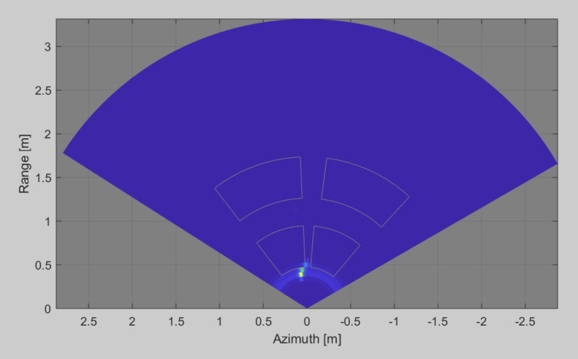

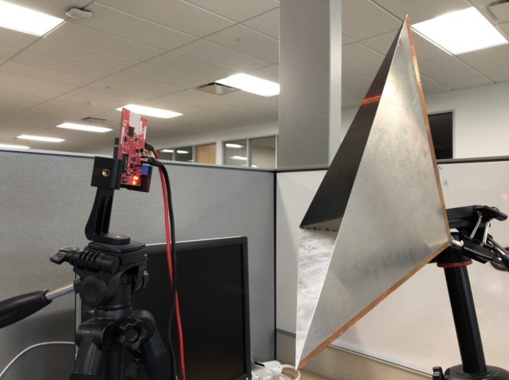

    I ran an experiment for this:  I placed a large corner reflector ~23cm from a 1642 EVM:
    This is a very large RCS and produces a single bright spot in the heatmap:
    Looking through the heatmap data, the bright spot is in range row 7, azimuth col 27.  The value of this cell is 512215.1.  This isn't an overflow, as the cells moving away from this cell decrease continually in value.  I then looked through the radar cube data for range bin 7, and saw very large values, but I couldn't tell if anything was an overflow.  All values had a few sign bits at the top.  I also looked through the current ADC data and also saw large values, but nothing that jumped signs quickly indicating an overflow.
    I have two suggestions if this is an issue that needs checking in the device or host:
    1) Check the heatmap values.  They should never be negative. The customer can test for what the expected positive maxcan be, then either discard larger values or saturate them.  Remember that this only needs to be done in the defined zone regions.
    2) Enable the Rx Saturation Monitor in the RF front end. See AWR_MONITOR_RX_SATURATION_DETECTOR_CONF_SB in the Radar Interface Control Document. Rx Monitor support was added to the Out Of Box demo after we implemented VOD, so it is not supported in this demo, but could be added by the customer by porting those sections of OOB to VOD.  Even with this enabled, there is no guarantee that something won't overflow downstream.  So #1 may be the best and easiest option.
