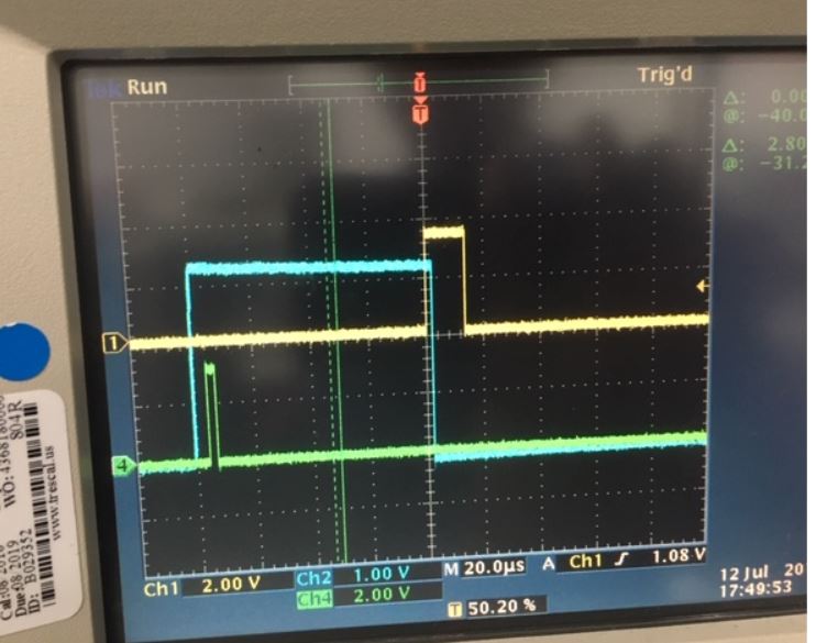

    Please confirm if you are using the TDC1000-TDC7200EVM, I have attached a register map for this EVM wherein we have a 1Mhz transducer connected to a plastic container to measure its level. I have also attached the plot for START, STOP & INTB that we observe in our lab here with this EVM. The Green is START, Yellow is STOP & Blue is INTB.

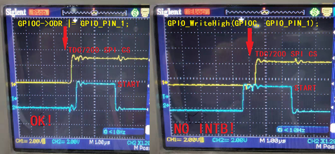

  • I have been having the same problem with INTB for the last week. I have two different design boards using different processors, One works ok, the other does not assert INTB.
    I found that the IDLE states of the SPI bus were the problem. The working board has an idle state logic 0, the non-working board and idle state of logic 1. Communication however was ok on both boards and the START and STOP signals were correctly asserted.
    Ensure your idle states are logic 0.
    I keep checking, as I could not believe this was the problem.
    Geoff
  • Geoffrey,

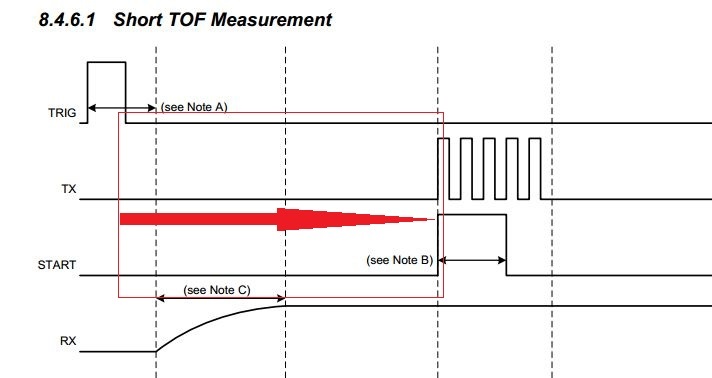

    Thanks for providing inputs as for the cause for INTB not showing up, we will now need to check if this is a real case as well.
  • Thank you Geoff.
    The problem is solved, as shown below:
    As shown below, this is why there is no problem with SHORT TOF.
    I think the TDC7200 design is not perfect.
