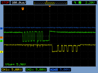

I am trying to read Ultrasonic measurement result between a MCU board ( Infineon XC2267M) to BOOSTXL-PGA460 (PGA460-Q1 Ultrasonic Sensor Signal Conditioning EVM With Transducers).
0x0B UART EEPROM bulk read executed OK
but 0x05 Ultrasonic measurement result get response ---Invalid command sent from master
===========try sample data as PGA460 datasheet in page 55 (with master generated checksum)=================
Example4 – Execute command 5 (ultrasonic measurement result), where PGA460-Q1 address is 0x0,
Master to PGA460-Q1: 0x55, 0x05, 0xFA …

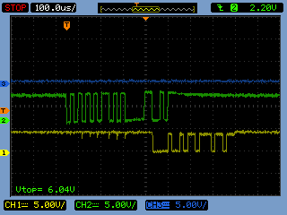

======================try sample data without master generated checksum======================
see scope screen below
for 0x05 Ultrasonic measurement result , both request get Diagnostic Data Error status [4] Invalid command sent from master
can anyone help to check what was missed?
Aaron
  • the decoding in last post is wrong,
    for 0x05 Ultrasonic measurement result , both frame has decoding 00010010B for Diagnostic Data field. which means
    Error status [3] Invalid checksum received from master (essentially a calculated slave checksum does not match the checksum transmitted by the master)
    then the question becomes why PGA460 response Diagnostic Data field with checksum error while MCU is still transmitting master checksum?

  • Hi Aaron,
    In your use-case, are you executing the following commands to read back the ultrasonic measurement results properly?:
    1. Write to the thresholds registers to clear the THR_CRC_ERR. This can be done as a bulk threshold write (command 16) or individual register write.
    2. Send a burst/listen command (command 0-3) while DATADUMP_EN=0 (start-up default)
    3. Wait for the burst/listen command to finish execution based on the present record length time (between 5-66ms). I recommend you wait 100ms for debug.
    4. Then send the ultrasonic measurement results command (command 5)
    The master generated checksum is not required for command 5, or any other slave response command other than single register read.
    What command do you send prior to command 5? Note, if a particular diagnostic field bit is set to 1 then the associated communication error has occurred sometime between the last response operation and the current response operation. This means the error is being reported for the command sent previous to command 5. What happens when you send command 5 two times in a row? Does the last response still report an erroneous diagnostic field?
  • Hi Akeem,
    Thank you for your support even in the weekend.
    here is my UART command send after the power up
    11, EEPROM bulk read
    12, EEPROM bulk write
    16, Threshold bulk write
    0, Burst and listen (Preset1)
    5, Ultrasonic measurement result
    I believed you already pointed out the checksum error report on frame 0x05 is from previous frame 0x00.
    for command 0x00, I used the data and checksum from PGA460 datasheet as below.
    Master to PGA460-Q1: 0x55, 0x00, 0x01, 0xFE
    my current writeframe checksum function doesn't work well, would you please check whether 0xFE is correct checksum for  above command 0x00?
    it would be appreciated if you can provide a C writeframe checksum function for PGA460
