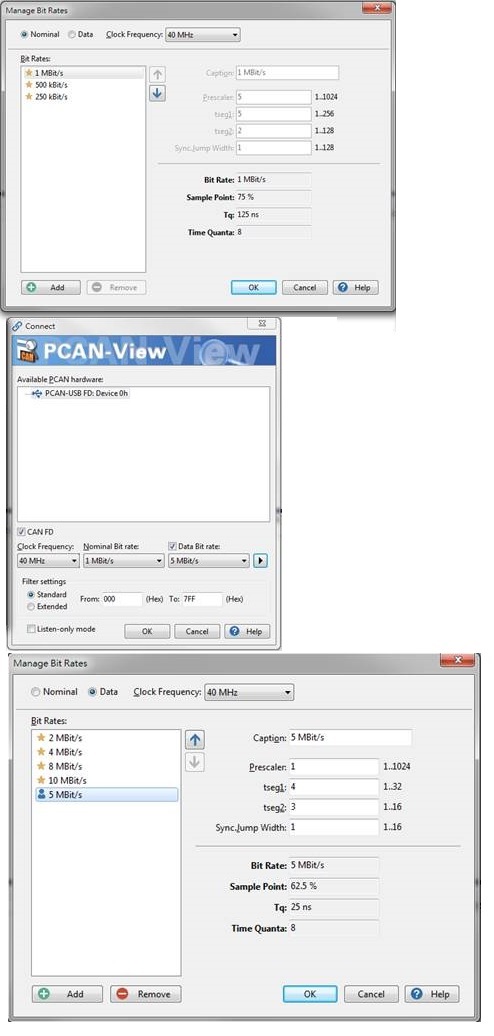

I tested lab0005_object_data_over_can on AWR1642BOOST.
I refer to ObjectDataOverCAN_GettingStartedGuide.pdfto set up my test environment.
Connect the PCAN-USBFD CAN lines to AWR1642BOOST.

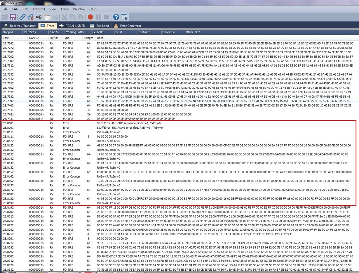

The demo is working fine, but there are some error.
How to fix Rx error of CAN FD ?
