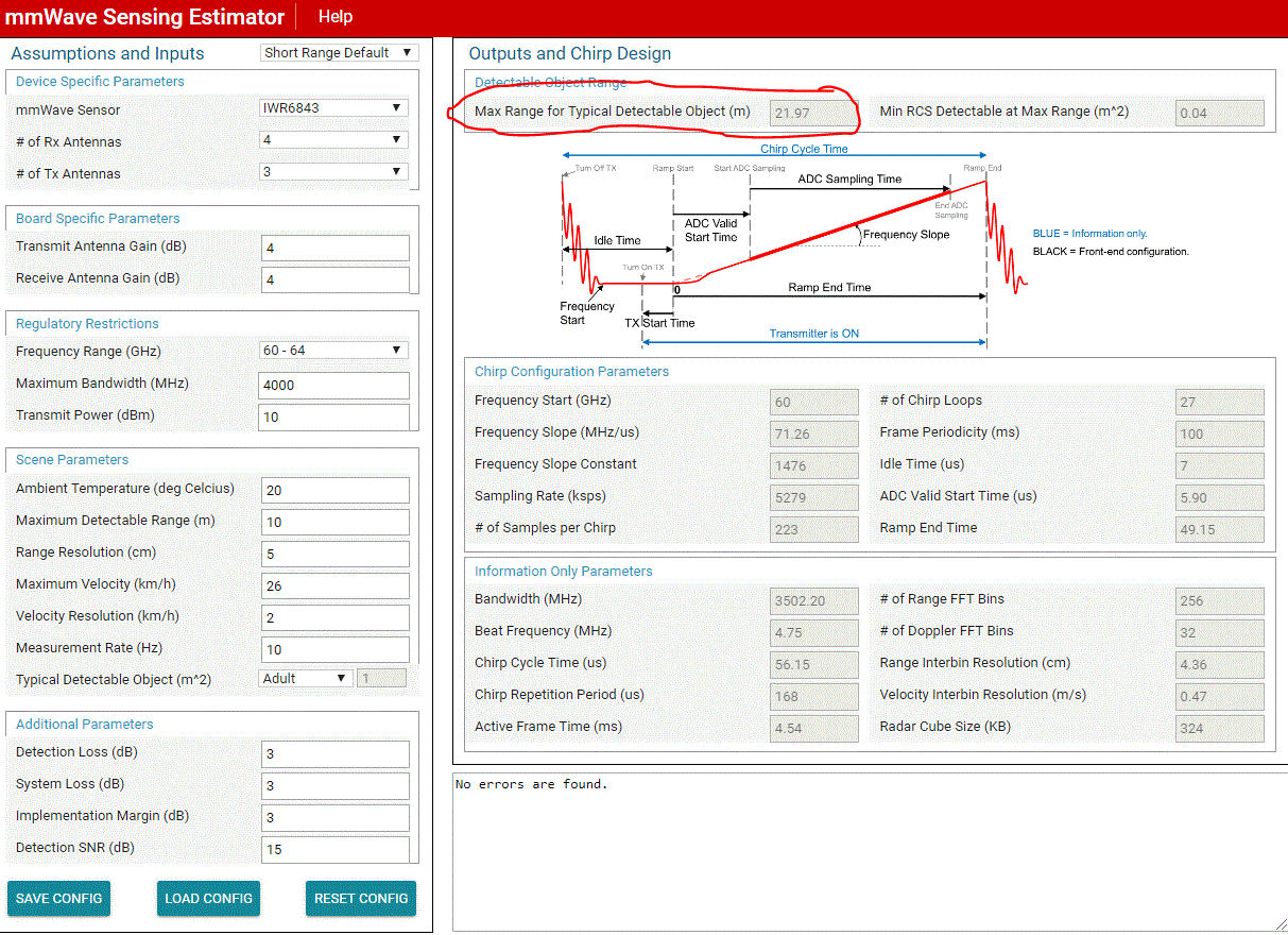

    Typically Link budget would be used for evaluating the module's quality.
    In this, a known RCS would be kept at a known distance from the Radar and received signal strength would be measured. And this measurement would be repeated at various angles, and if we plot the magnitude of measurement then it would results as shown in the below plot.
    And Module system parameters are captured through mmWave sensing estimator (https://dev.ti.com/gallery/view/1792614/mmWaveSensingEstimator/ver/1.3.0/) and max distance for a given SNR could be estimated as shown below.
    All these measurements are relative measurement.
