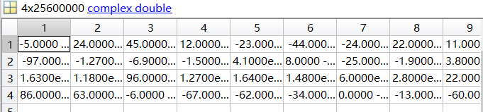

 Although data can be acquired, after reading by MATLAB, it is found that half of the channels are missing, only four channels.
       I am sure  I  select  both Tx1&Tx2 in StaticConfig,  and then Follow your steps  set the  "Chirp" configuration .
      The config: 200chrips*500frames*256samples=25600000,The raw data read is as follows:
This is only 4 channels data,if I want to get 8 channels data,what should I do to config the Tx0 & Tx1?
Can the AWR1642 get 8 channels of data? Some people say'YES',and others say'NO'.

    The ADC data is always from the Rx channels only. If you are using Tx0 and Tx1 in different chirps  , for example chirp 0 you use TX0 and in chirp 1 you use Tx1, then you will receive the 4 channel Rx data for 2 chirps. The first chirp data will correspond to Tx0 and second chirp data will correspond to TX1.
    Vivek

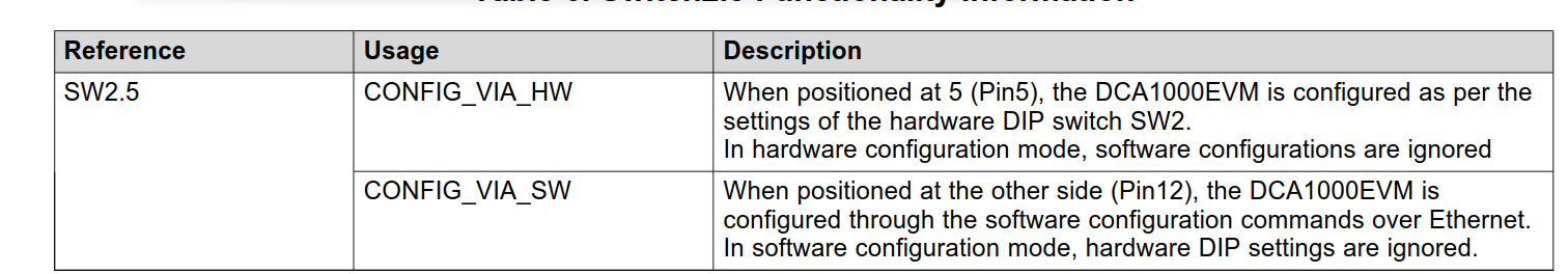

                The DCA1000 user guide show user can select the CONFIG_VIA_HW or CONFIG_VIA_SW, But I still don't quite understand
        how to configure the waveform through SW2.Can you provide a detailed operating instructions? Can the DCA1000EVM work independently
       from mmwave studio?
    The SW2.5 control switch  is for selecting the configuring mode for DCA1000, not the AWR device.
