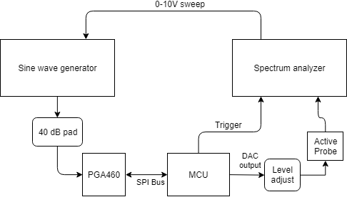

Diagram of test set is below.
In this test, MCU received a frequency to use from the host PC, configured PGA460 with appropriate BPF coefficients and frequency value, and then continually issued "listen only" command. PGA460 was configured in direct data burst of BPF output, at 8 bit/sample, 65.536 ms record interval, and minimal possible gain of 36 dB. Data was received at 1MSPS by MCU, and converted back to analog via MCU's integrated DAC. This analog signal was fed to a spectrum analyzer. MCU was programmed to generate a pulse for the analyzer upon the first data sample in each "listen only" command, triggering it to do a 110 kHz - 1.1 MHz sweep in 50 ms. A signal generator was synchronized with the analyzer and provided a synchronous sine sweep to the input of PGA460. As a result, in this setup we have received a frequency response plot - which was then retrieved by the host PC.
With this setup, we have retrieved a frequency response plot for each configurable frequency in the high frequency mode of PGA460 (180-480 kHz with 1.2 kHz step) which I have attached to this post as a PDF file. Actual peak frequency of the BPF estimated with analyzer's "peak search" function is available in the top right corner below "MKR" label, and the programmed frequency according to the CSV just below that.
PGA460 internal oscillator frequency variation was a concern during measurement. To ensure an acceptable degree of stability during test series (which took around 30 minutes), all equipment, including UUT, were powered up 4 hours before testing started, all testing was performed in temperature-controlled room kept at 30°C, and PGA460's oscillator frequency was measured before and after test run. During both measurements, frequency of 7.968 MHz was observed, with 8 MHz expected. As such, -0.4% frequency offset should be expected. This offset is not corrected for in the plots themselves or the numbers below.
It can be seen that frequency offset indeed exists and is rather significant. At 180 kHz, actual center frequency is around 191k. At 332.4 kHz, it reaches 481.3 kHz, and a step above that the filter completely falls apart and no longer has any discernible response. With the further increase of programmed frequency, it "goes around", and at 362 kHz programmed frequency, it peaks at 115 kHz actual, and continues to rise in frequency after that, however somewhat erratically.
Now, the question: is this behavior expected?

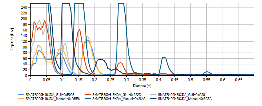

    Here is the analysis I performed:
    I spot check the performance of three different Steminc brand high-frequency transducers:
    • SMATR200H19XDA (200kHz)
    • SMATR300H19XDA (300kHz)
    • SMATR400H99XDA (400kHz)
    I swept the entire range of A2 coefficient values currently offered by the 180-480 kHz in the GUI. I then found which A2 coefficient yielded the greatest echo peak amplitude for a fixed distance object detection. Here are the differences between the GUI suggested A2 coefficients versus the manually tuned coefficients for the three transducers:
    Just as you have observed, the lower end (e.g. 200kHz) of the high-frequency range matches more closely between the GUI recommended and the manually optimized A2 coefficient value, while the higher end (e.g. 400kHz) of the high-frequency range shows a much greater mismatch between the GUI recommend and manually optimized A2 coefficient value.

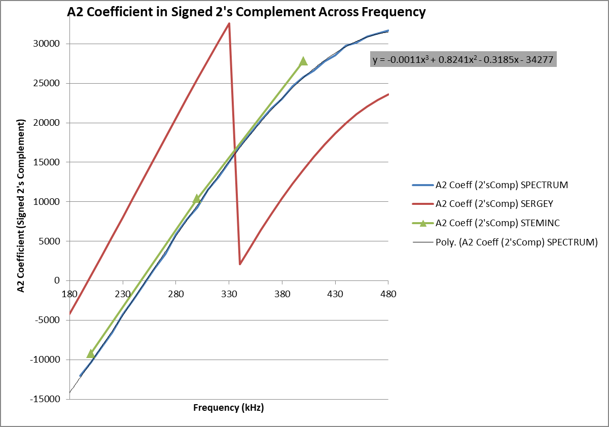

    Using these spot checked data points and your characterization plots of the BPF, I was able to generate new 3rd order polynomial trend line equations for the A2 coefficient. Here is the example for an 8kHz bandpass filter bandwidth: y = -0.0011*x^3 + 0.8241*x^2 - 0.3185*x - 34277
    where:
    • y is the A2 coefficient value in signed 2's order complement integer output
    • x is the transducer center-frequency in kHz
    Here is the charted version of the new A2 coefficient equation (8kHz BPF BW) to show how the actual values compare to the trend line equation based on your BPF plots. The issue with your equation is the roll-over at ~340kHz due to the lack of taking into account the signed nature of the 2's complement value.
    where
      • SPECTRUM refers to your BPF characterization
      • SERGEY refers to your A2 3rd order equation for an 8kHz BPF BW
      • STEMINC refers to the three spot checked transducers
    Here is the tabulated comparison at 10kHz steps:

    The higher end may require some additional manual fine-tuning, but this equation yields an overall improvement across the entire high-frequency range.
    I will upload the latest version of the GUI and look-up table next early week.

  • Hi Sergey,
    After implementing my new equation in the GUI, and re-validating the performance of the 200kHz, 300kHz, and 400kHz transducers, I have optimized the GUI based equation for the A2 coefficient as the following: A2_Coeff_at_8kHz = (-0.001*f^3) + (0.658*f^2) + (63.5*f) - 39877
    I have submitted the updated version of the GUI (v.1.0.2.0) for upload to TI.com. It will be available for download this week.
