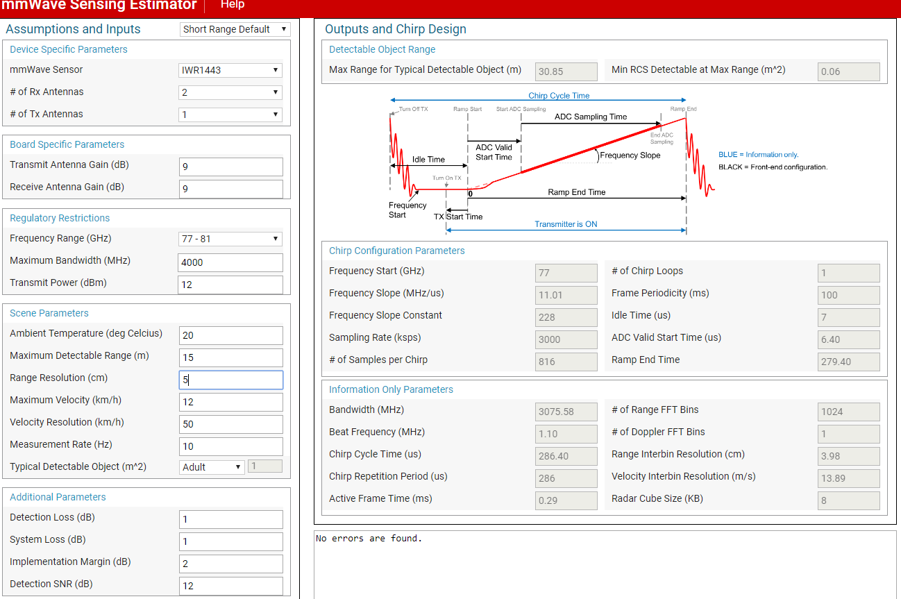

We're trying to find an optimal configuration for a level sensing application at a max distance of around 15 meters. Were trying to use the mmWaveSensingEstimator to generate a chirp design. Unfortunately the design generated with the estimator is not accepted by the device (an error is thrown). As we're trying to detect static objects I've set the max velocity to 12 and velocity resolution to 50. The resulting configuration is not accepted. I've also tried to load the configuration that is used in the level sensing demo of the high accuracy lab (profile_2db.txt), this one also throws an error.
I have attached a screenshot of the level sensing estimator and the configuraion file created based on the level sensing estimator output. Could you help out in finding what may cause the error in this configuration? Or would you have a general suggestion for a configuration that can be used for our application?

    I'll need some more information in order to assist you. Can you confirm which SDK version you are using? Can you also confirm whether your IWR1443 is ES2.0 or ES3.0? The High Accuracy lab is only compatible with mmWave-SDK 1.2 on ES2.0 at this time.
    I am also wondering which visualizer you are using. The standard mmWave-SDK visualizer is intended for evaluation and may not support all chirp configurations that are generated by the Sensing Estimator.

  • Hi Bart,
    Would you be able to post what kind of error you are seeing?
    Also please keep in mind that the mmWave Demo Visualizer does not support all chirp settings out of the sensing estimator, as it is just an evaluation tool.
    Have you tried a separate visualizer such as the zone occupancy demo?

  • Hi Akash,
    An assertion is hit on this line of the mmWave Demo (in MmwDemo_frameStartIntHandler()):
        /* Check if previous chirp processing has completed */
        MmwDemo_debugAssert(dpObj->interFrameProcToken == 0);
    I have not tested the separate visualizer yet. I can do that, but my main goal was to get an understanding of what settings from the mmWave estimator are best suitable for our application and will be accepted by the sensor.
