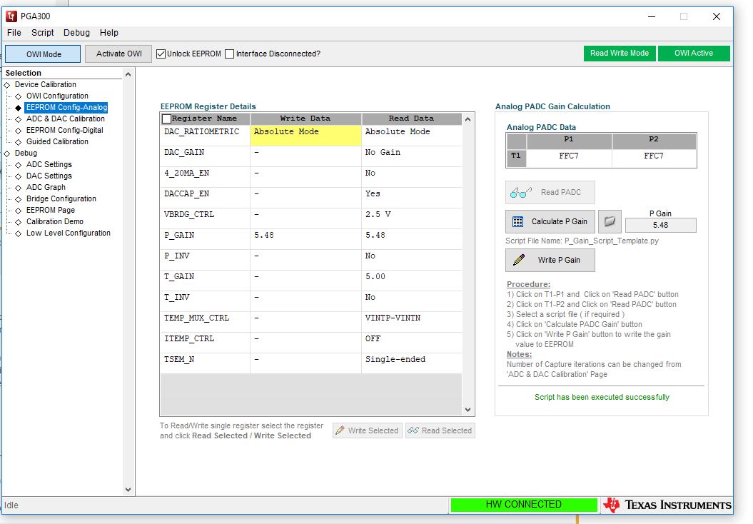

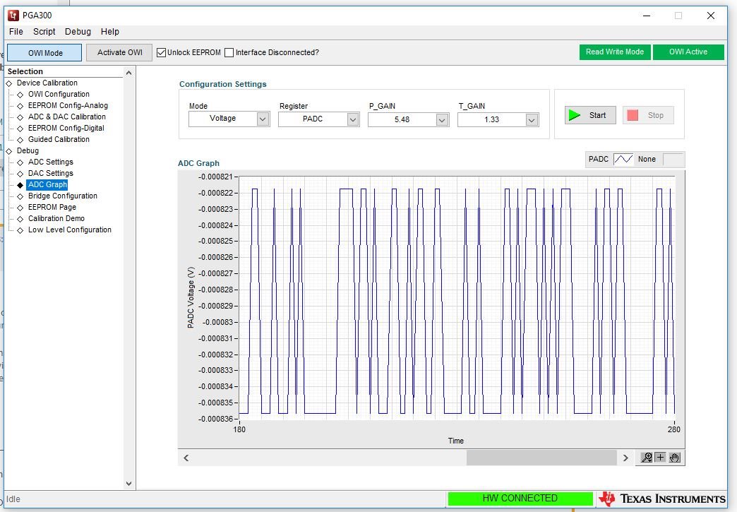

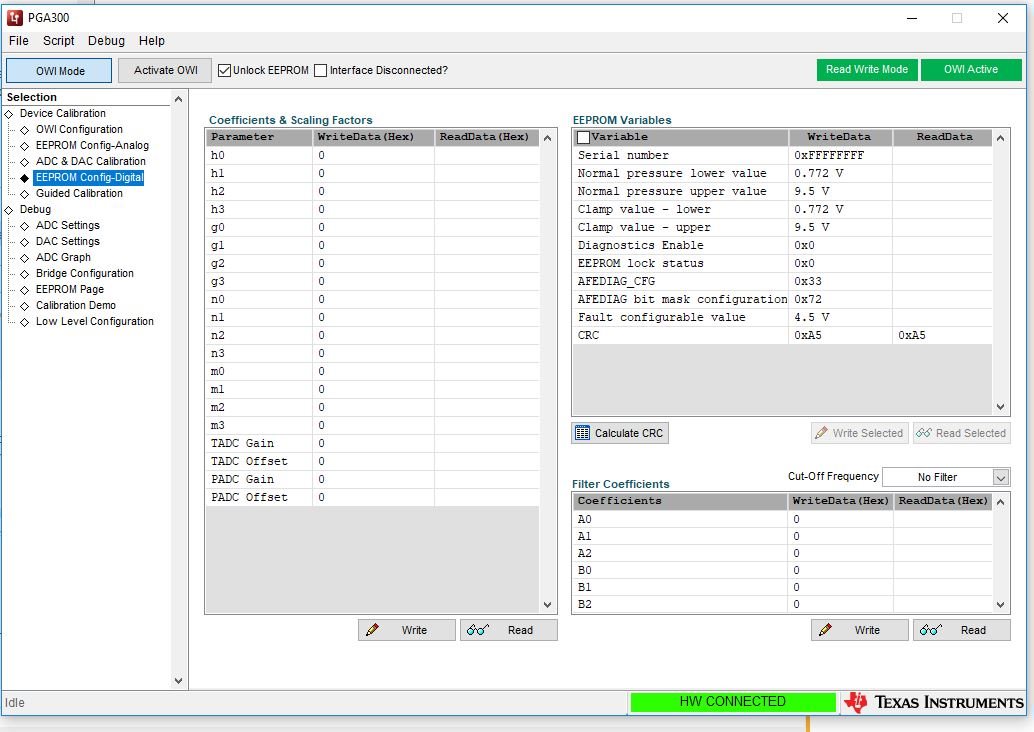

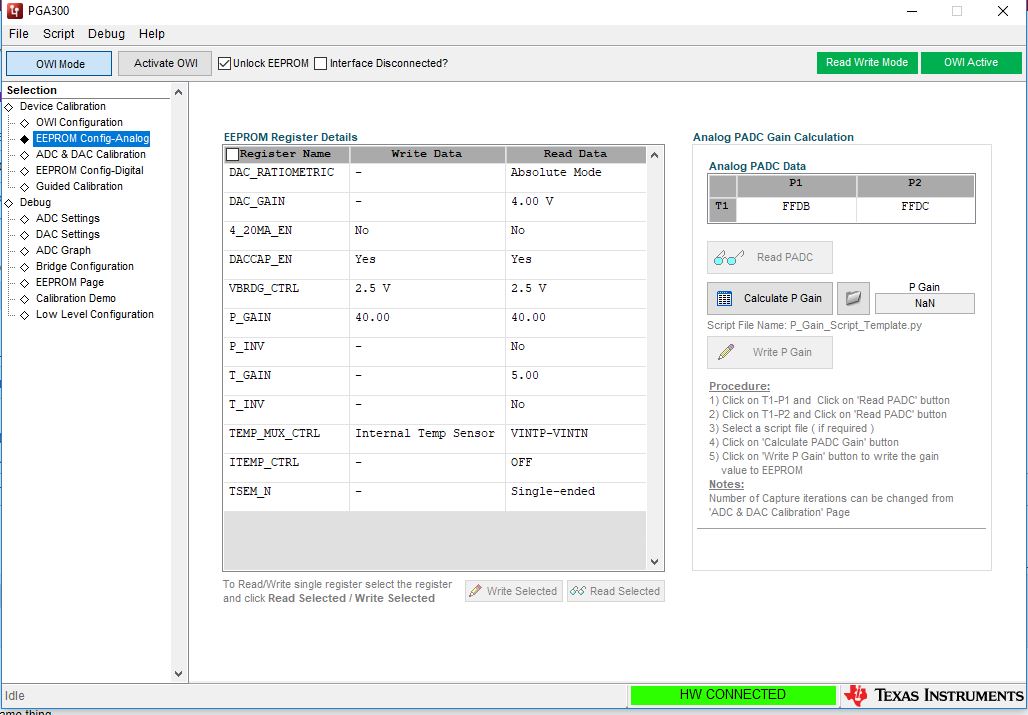

I am trying measure external piezoresistive sensor with Pga300evm-034. But I am reading negative value. And value isn't changing with pressure. My settings are in attachment. Piezoresistive connections;
In+ : external 5V Power Supply
GND: GND
Out(+) = TP34 (InP-)
Out(-) = TP35 (InP+)
What is the problem?
