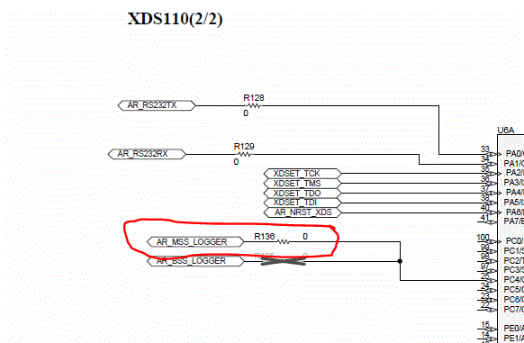

I'm working on my masters' thesis, developing an obstacle detection algorithm based on LIDAR and RADAR sensor readings. I have managed to connect the LIDAR sensor through USB and, as such, the USB port is unavailable for connection. I'd like to know if there is any guide or if anyone can give a detailed explanation on how to connect the IWR 1642BOOST EVM (Rev. B) to the Arduino Mega ADK using the connector pins (within J5 and J6 if the information I've gathered is correct) and if any prior modifications have to be made on the module (such as replacing resistors).

        If you want to use IWR1642BOOST EVM stand alone, I guess it's power through external power supply and configuration is out of box demo. As hardware configuration would be different for different demo applications.
    In out of box demo application, device processed output point cloud would come out through UART Tx pin "AR_MSS_LOGGER". This may need R136 resistor removal from the EVM  which connects to XDS110 device.
    This pin need to be connected to "UART RX" pin in the  Arduino board.  And you may have to build a driver + application code to process this.
    Ofcourse you may have to connect few ground pins so that both the boards have common ground to work with.

    Thank you for your response. By removing resistor R136 and connecting the pin No.2 (GND) to the Arduino's ground pin, I would successfully be able to receive point cloud data on the Arduino Rx pin? If that is the case, would this data be organized into the same packet structure as the OOB demo connected to the matlab visualizer?

  • Hello Tiago,
        Yes, data would be organized into the same packet structure as the OOB demo, as long as same  binary used in the mmWave sensor.
