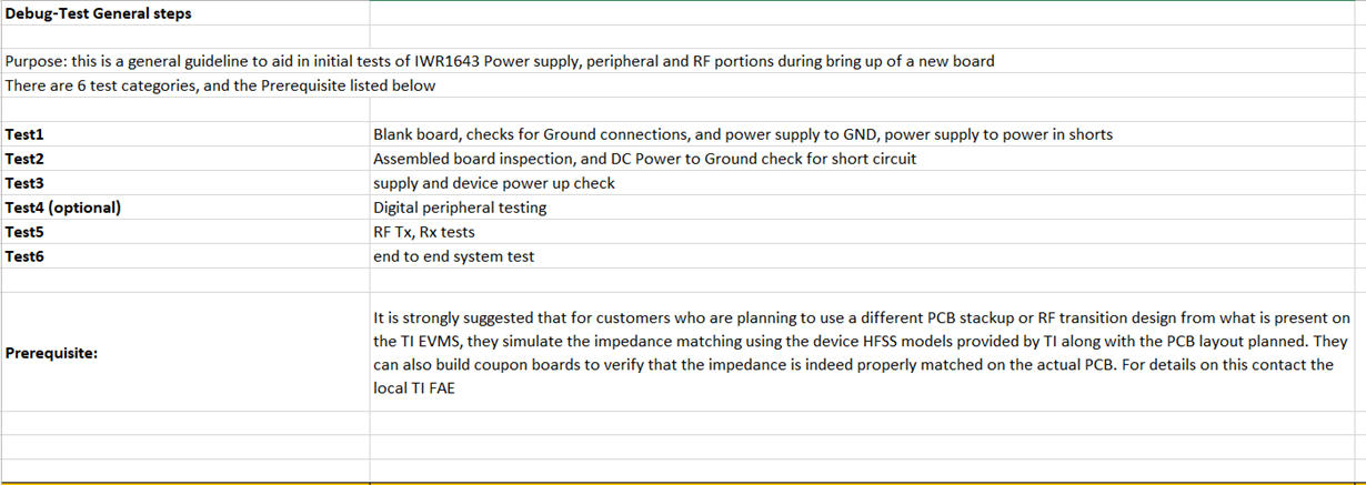

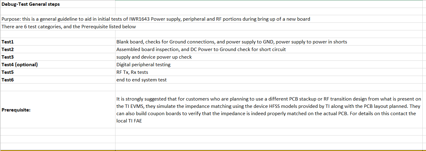

I am working on designing di-electric lens, radome and analyze patch antenna for my custom PCB. Its mentioned in the hardware guidelines about the HFSS models provided by TI can be used as starting point for the simulations. Where can I get download them, kindly share with me.
