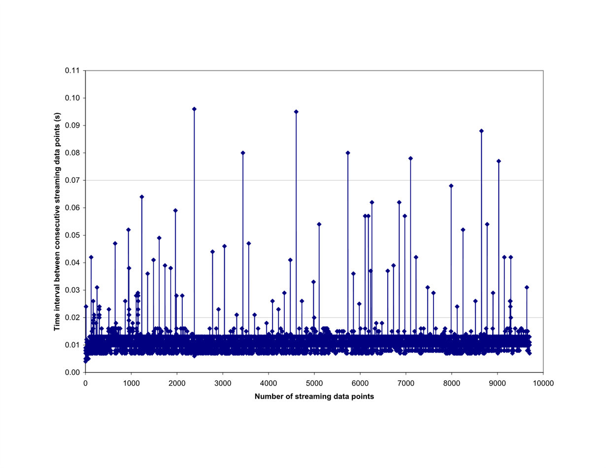

I have successfully done my Labview program to  fully control FDC2214 EVM. I found that time interval between two consecutive streaming data points has some spikes. The attached chart shows the result, which was obtained using only channels 0 and 1, stream reading lasted for 105 seconds after stream start and 9700 streaming data logs were recorded in a spreadsheet, average 92 streaming samples per second, which included about 5 repeating value numbers for each data with a new value.
Majority of the time intervals was 10 ms, the highest was 95 ms, meaning 9 times longer than average.  Can someone tell me what is the cause for the time interval spikes?
 My Labview program followed the Python program sample  Q&A 41 provided on TI web.
  • Hi Gu,
    I believe this is likely due to Labview. When your VI runs on the computer, it is sometimes placed at a lower priority than other tasks running on your computer, causing the additional delay. I don't think there is necessarily a problem with your code or with the EVM. You might ask for help on the NI forums. Typically they give quick responses.
  • Hi Kristin,
    I already contacted NI and was told that it is likely due to computer system's jitter, some background software may rise to occupy CPU.
    The streaming data acquisition is a software timed operation, which can be influenced by many factors. A very important one is live data (XY graph) display updating, the more data collected the longer time is required to process the graph, making the time interval of 2 consecutive streaming data points an ascending trend.
    Is there any way that the streaming data acquisition can be hardware timed operation using the onboard time clock?
    Gu
  • Hello Gu,
    While you can certainly time the data collection from the FDC2214 using the MCU's clock and store that data on the MCU for future use, I do not think there is a way to stream the data using hardware timing. Any transactions over USB are going to be subject to the computer's software timing.
