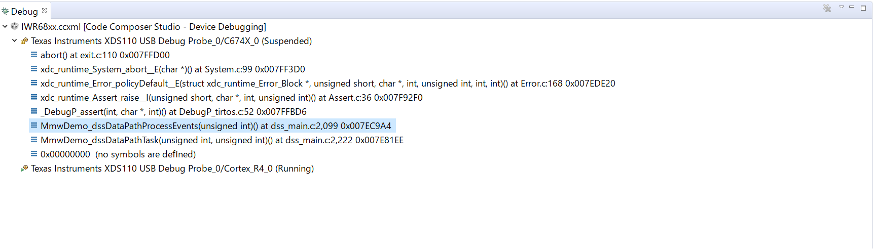

It could be started, but it was stopped when many points/objects appeared.
I tried to find the reason with CCS, but I could not find it.
The console text and capture of the Debug window are also attached.
Q1. What is the reason of sensor stop ? I will send other information if you need for analysis.

[C674X_0] Debug: MMWDemoDSS Data Path stop succeeded stop1,frames:4859
[Cortex_R4_0] CFAR Config sent successfully
Debug: System Heap (TCM): Size: 98304, Used = 55736, Free = 42568 bytes
Debug: (GtrackModuleInstance *)0x8009d30
Debug: MMWDemoMSS Received CLI sensorStart Event
MMWDemoMSS config success!
Debug: MMWDemoMSS mmWave  config succeeded
[C674X_0] Heap L1 : size 16384 (0x4000), free 4096 (0x1000)
Heap L2 : size 49152 (0xc000), free 34888 (0x8848)
Memory allocation successful
Heap L3 : size 786432 (0xc0000), free 370688 (0x5a800)
{module#8}: "../dss_main.c", line 2088: error {id:0x10000, args:[0x81a444, 0x81a444]}
xdc.runtime.Error.raise: terminating execution
[Cortex_R4_0] Error: Unsupported Mailbox message id=-18022141

  • Hi Justin,
    The issue wasn't happened in the case of the frame period changed from 100ms to 150ms.
    It is supposed that the frame processing was not finished in the case of period 100ms because it was very short time (1.5ms) from the end of a frame and the beginning of the next frame.
    Do you think the guess can be happened ?

  • Hi Justin,
    Thank you for your comments.
    1. It seems the crush is in DSS. It was shown that "../dss_main.c", line 2088: error ". The line is assertion for dataPathObj->chirpCount == 0.
    I'm not sure but it is supposed that the processing time was not enough to increment the chirpCount.
    Anyway, it has not been occurred crush for a few days with 150ms frame rate, I will take it.
