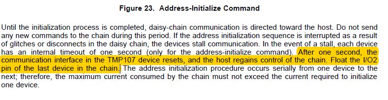

  • Hi Mihail,
    Please find the below section of datasheet which says float the I/O2 pin of last device . Please let us know your thoughts.
    Thanks & Regards,
    Lokraj

  • Hello Lokraj
    The pull-up on the last part IO2 pin is not mandatory. Part has internal pull up 100 KOhm resistor, but if you have some long wire (antenna) connected to this pin and noise environment, some glitches can affect chain initialization and chain work. Otherwise you don't need it. But you can try.
