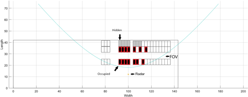

I've performed some tests with my IWR6843 and some elements surprised me and I'd like to know what could cause those phenomena.
  1. The pointcloud "moves" a lot. I mean, it seems that, even with static object, the detection of the object is unreliable. Sometimes, some points will appear where there is no object or the pointcloud of a static object change a lot. Is this a characteristic of radar sensor, or is this issue coming from computing/algorithms.

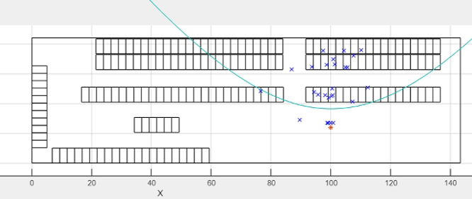

  2. In my use case, I must detect the occupancy of specific areas. But quite often the radar does not detect the objects, here is an illustration of one of my tests (reality vs pointcloud):
    What can be the reasons of these non detected objects ?
  3. Does the difference between the real area covered and the theoric FOV is due to the radiation curve of antennas or due to the low-level configuration (here is my configuration: 2D-profile40m.cfg)

  • Hi, Quentin:
    The tradeoff of miss detection and false detection can be tradeoff with different CFAR detection threshold.
    Are you using range FFT + Doppler FFT + CFAR detection + DOA algorithm in your post processing chain?
    With the CFAR detection,  a peak will be claimed if it is higher than the neighboring range bins.  But when the neighboring range bin are all quite strong, it may not declare as a peak.   In your case, traditional CFAR may not work very well.
    In addition in your system, it seems that both sensor and target are static, the radar system can not take advantage of the separation of doppler domain,  you may want to go through the range-angle domain for detection instead of range-doppler domain for detection.  You can refer to people counting demo for this range-angle domain detection.
    From your configuration, you have an angle of resolution of 15 degree.  You may want to consider using cascade radar system if you need to detect a lot of details that are close by.

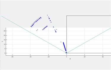

    But the result is quite unexpected :
    Currently, I don't know how I could solve this issue of detection.
    So, how can I modify the config from the Lab to increase its range please ?

  • Hi Quentin,
    Chirp slope determines the range. I recommend first lowering the chirp slope to get the desired range. Range calculation is described in this document.
