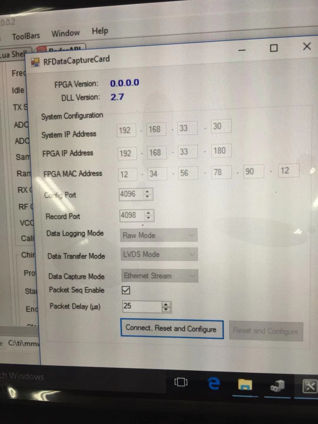

when I use DCA1000EVM,the problem happend:
I Can't connected the FPGA!
Other than that, I can be sure(Because it works fine on another computer):

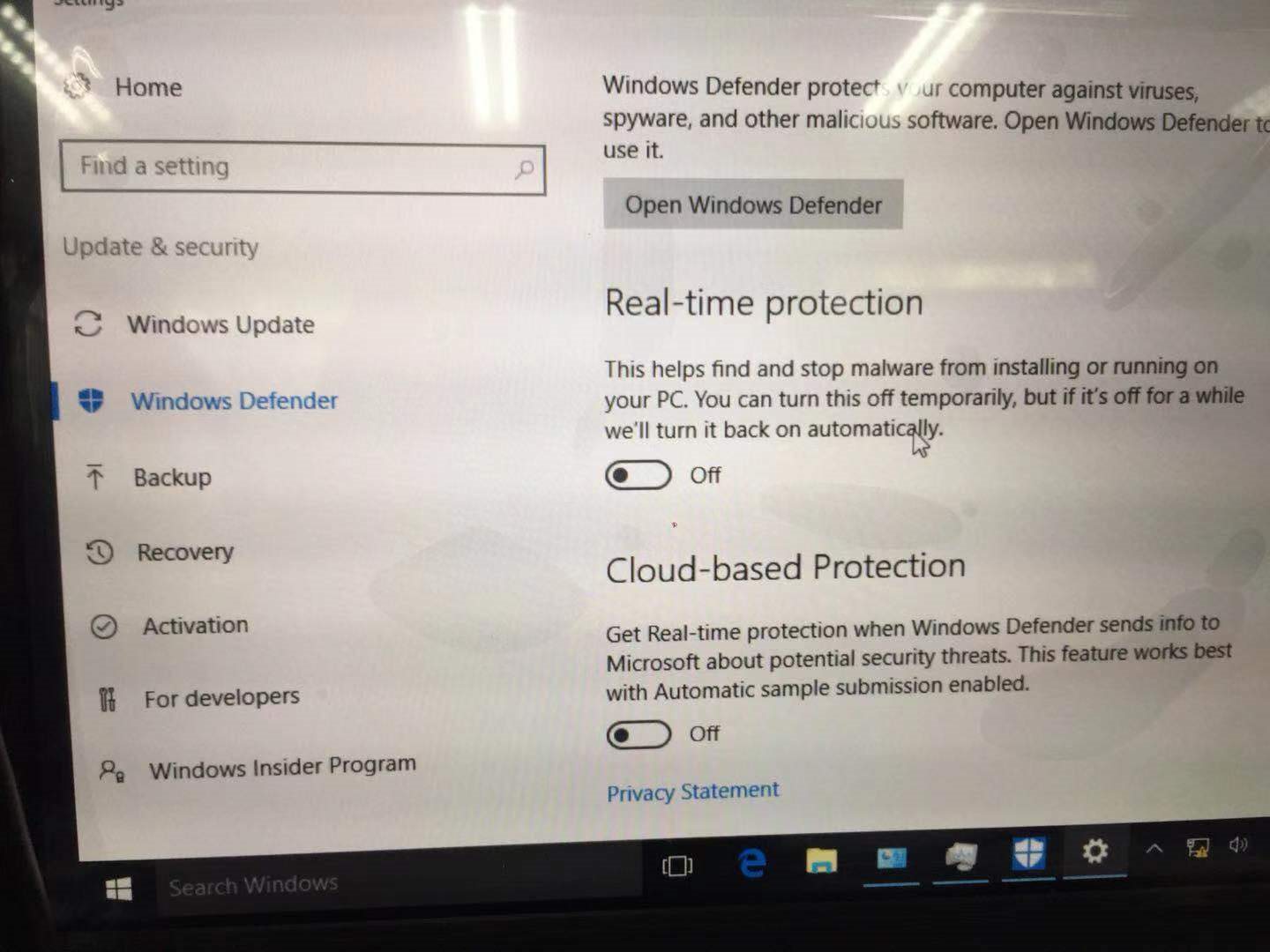

a)I have turned off the firewall;
b)The PC IP is correct!
c)The board is working properly;
d)Network cable is good;
e)SW2 configuration is correct;
I read all the descriptions of this question in the forum, but they can't solve my problem.
I hope you don't recommend me to change your computer, because for some reason, we have to finish it on this computer.
    This error is usually due to either a firewall blocking access to the DCA1000 or due to incompatibility with the ethernet adapter on the PC. Since you confirmed that you have checked the firewall, and that the DCA1000 works with another computer, likely this issue is due to the ethernet adapter on your PC.

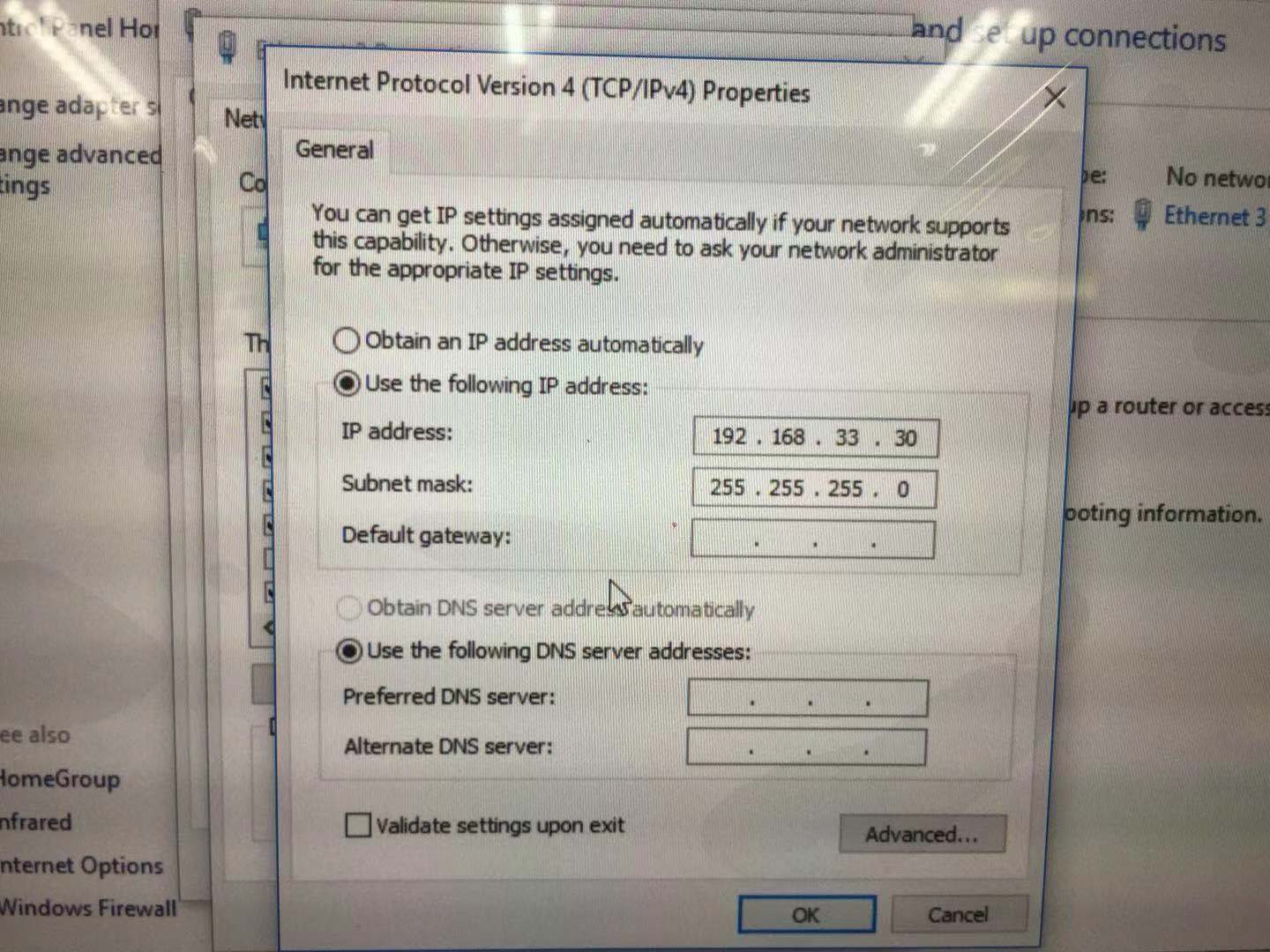

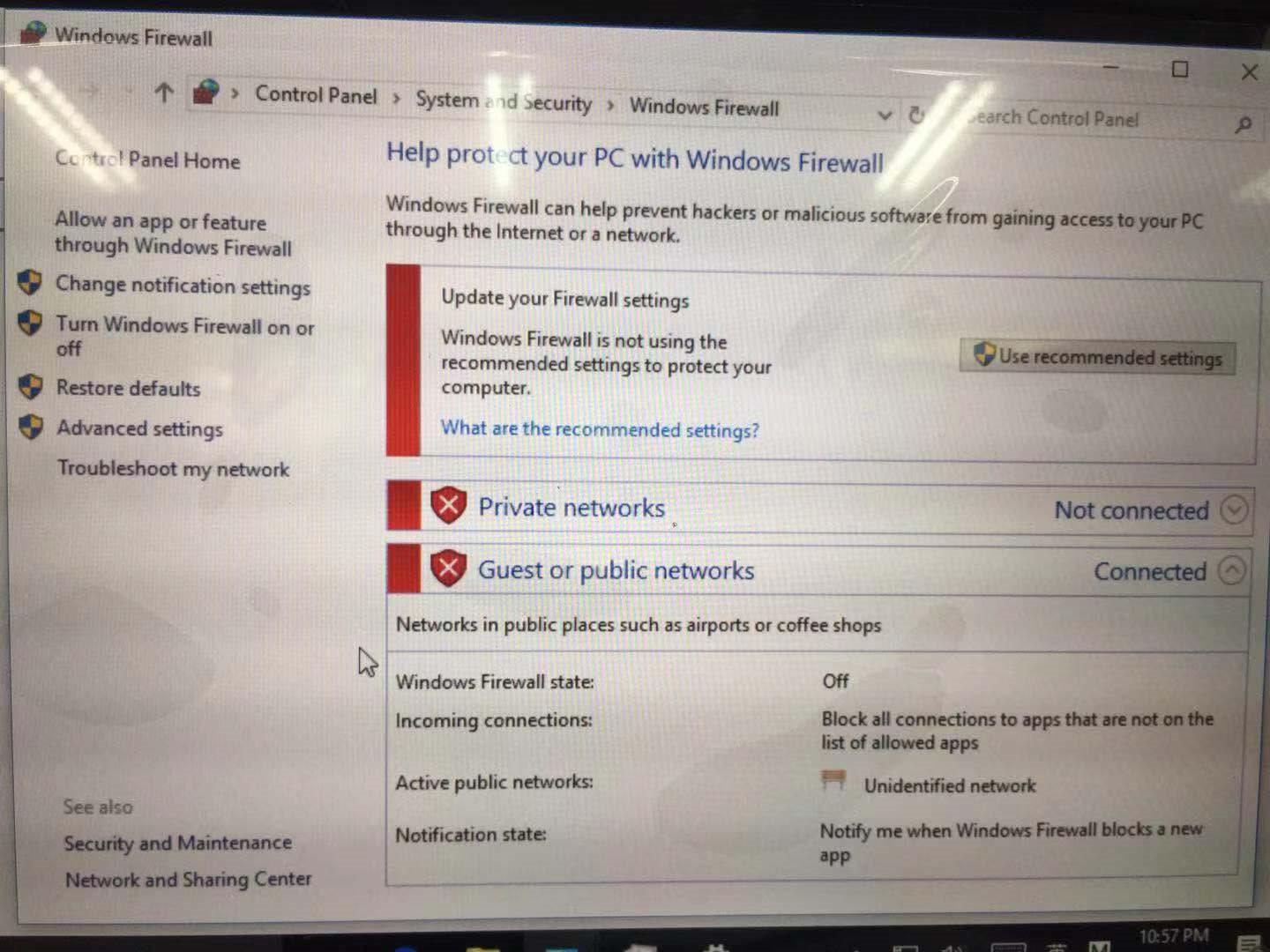

  •   First of all, what I want to say is that the advice you gave me has been seen before.The URL link is:
      e2e.ti.com/.../822320       RIGHT?
    In addition, I want to emphasize again that all the relevant solutions in the forum have been seen and tried, and they are useless.
    And I can be sure my firewall and static IP are correct. The following:
    I think a lot of people have encountered such problems, and you have not given an effective solution.

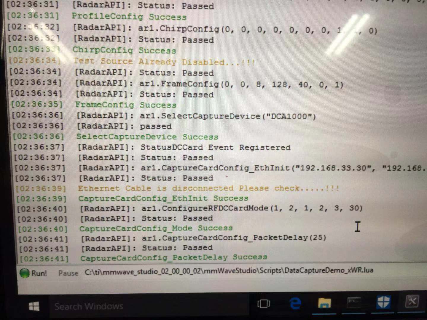

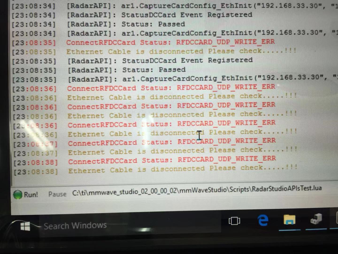

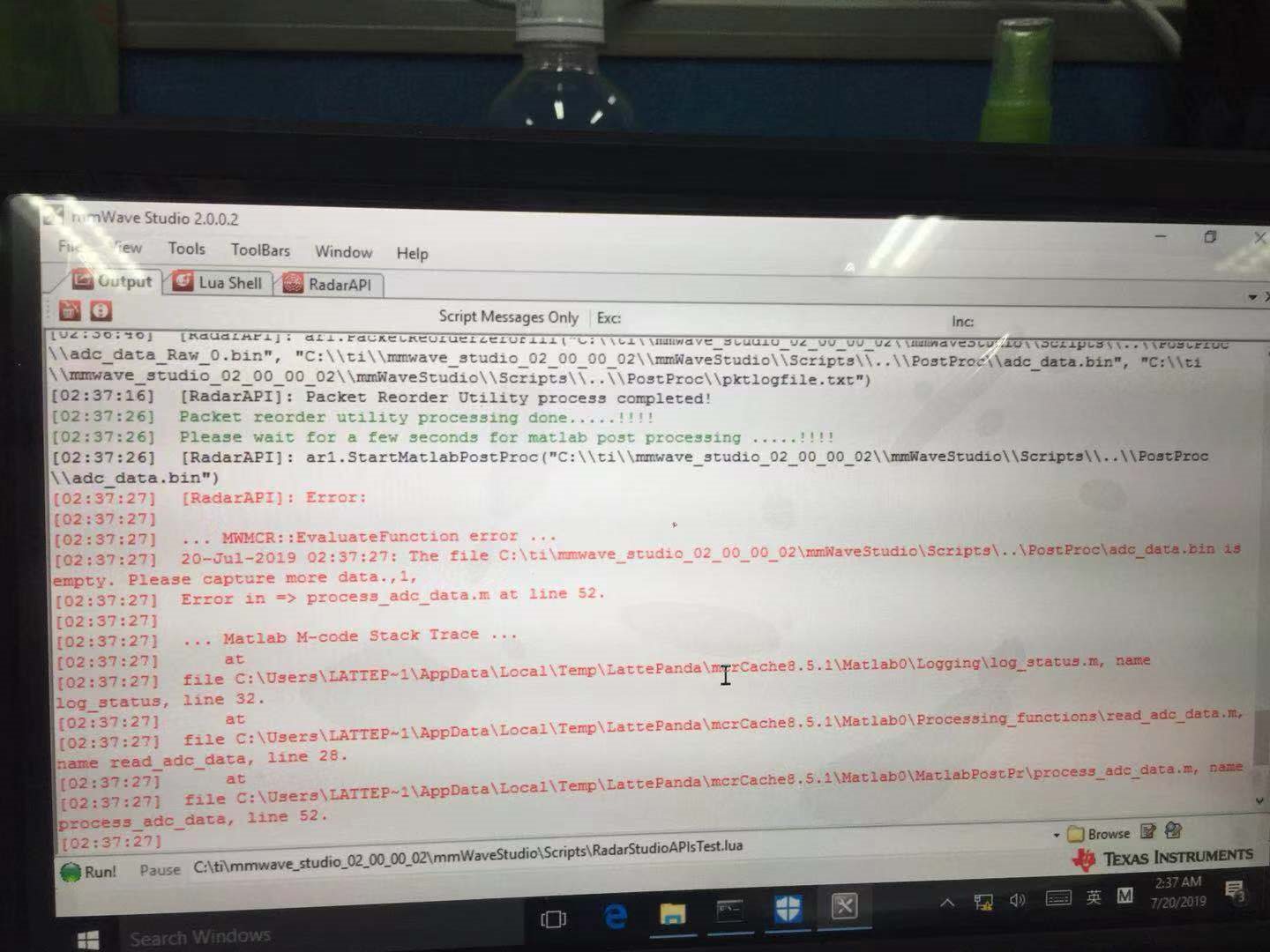

    When I run the DataCaptureDemo_xWR.lua ,the OUTPUT is the following:
    Please help me to solve the problem of the Ethernet disconnect,thank you!!
    Please make sure you use a USB3 Gigabit-ethernet converter or a PCI-based Gigabit ethernet network card.
    The DCA1000 requires Gigabit ethernet.
    Anand
