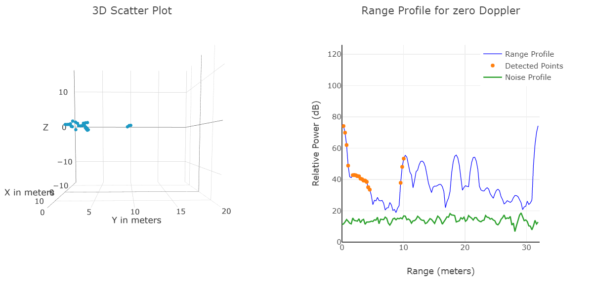

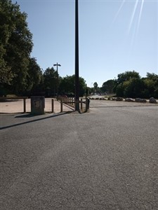

I'm trying to detect an electric pole with the mmWave Demo Visualizer.

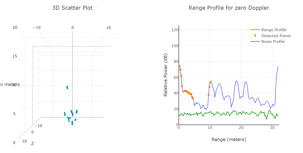

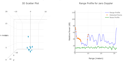

The pole is well detected but as you can see the detected points do not represent the pole (no points in elevation)
How can I improve that ?

    The "aoaFovCfg" command limits the elevation and azimuth field of views. It filters out points that fall outside the specified range in the azimuth or elevation plane. It is possible that the points of the pole that you are trying to detect fall outside of your elevation angle range. You could try to increase the minimum and maximum elevation angles (up to -90 and 90).
    Similarly, the "cfarFovCfg" command filters out detected points outside the specified limits in the range direction. Your command limits the range to between 2m and 8m. Depending on your setup and the distance of the sensor from the pole, you could try increasing the maximum limit to be larger than 8m.
