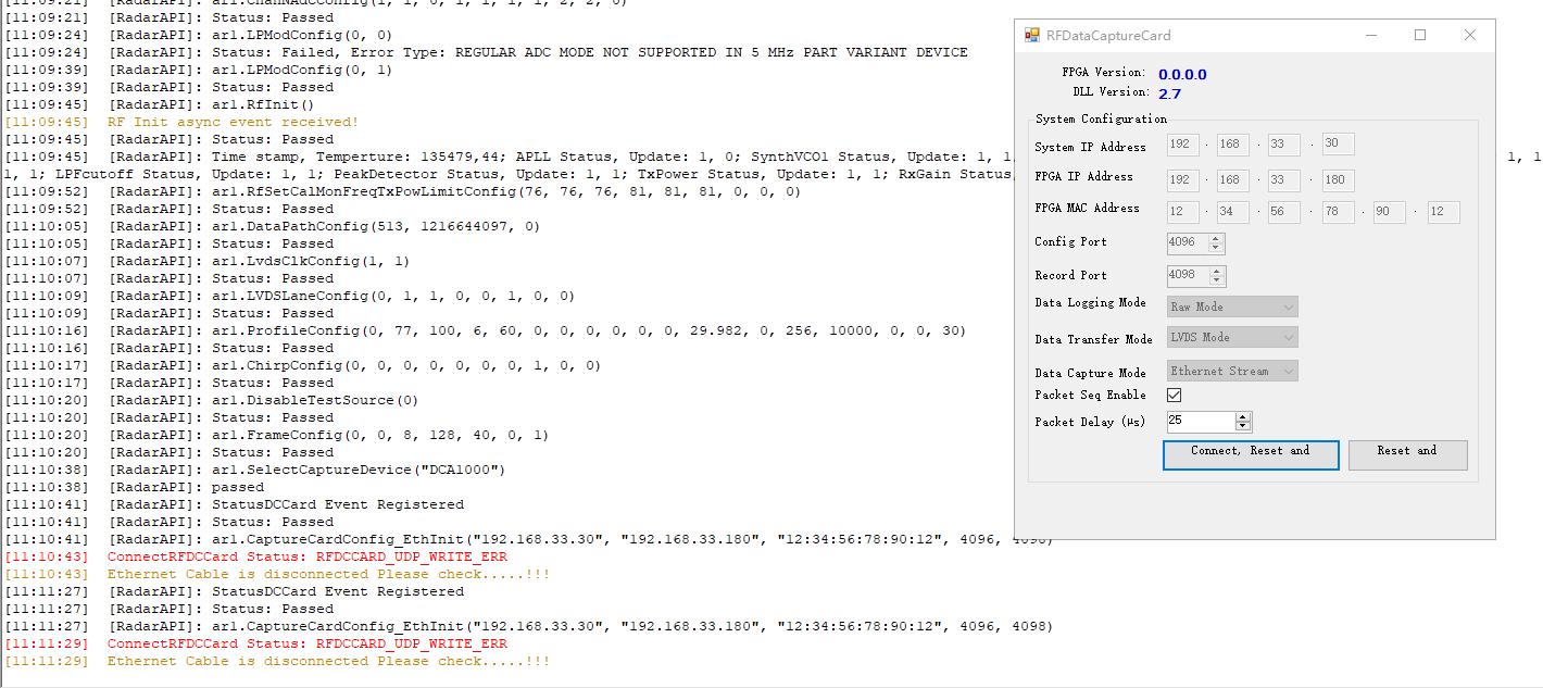

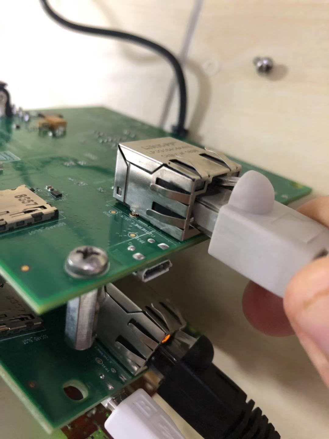

I bought a DCA1000EVM to capture the data of IWR1443,but I find the etnernet cable is physically disconnected.and when I try to run the data capture demo on the mmWave  Studio it will show disconnected.The indicator of the Ethernet port is off.

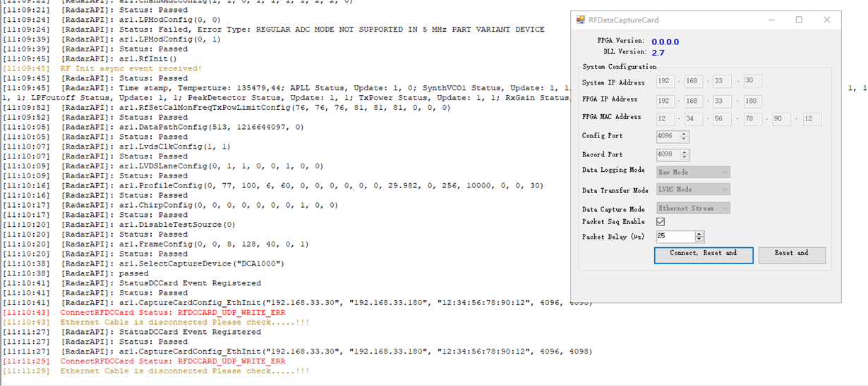

  • I have followed this video several times,but it does not talk about the ethernet connection.My device manamger looks like that. I do not know the problem.I am sorry I did not see the answer timely, please reply me.Thank you. And theStudio shows like that:
    [20:45:19]  [RadarAPI]: ar1.CaptureCardConfig_EthInit("192.168.33.30", "192.168.33.180", "12:34:56:78:90:12", 4096, 4098)
    [20:45:19]  [RadarAPI]: Status: Passed
    [20:45:21]  Ethernet Cable is disconnected Please check.....!!!
    [20:45:21]  CaptureCardConfig_EthInit Success

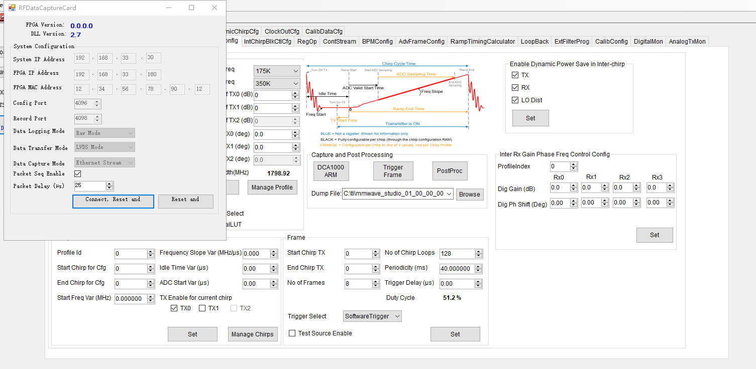

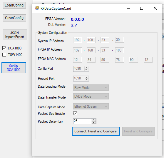

    Please send a screenshot of the 'Set up DCA1000' popup from mmWave Studio.
    -Chloe
  • I am sorry I do not reply timely. When I try to set up DCA1000 in the mmWave Stduio, the result like the pictures below:
    Which EVM are you trying to connect to?  Please erase the flash using uniflash and try again.
    -Chloe
  • I try to connect to the AWR1642 EVM and IWR1443,and capture the data then send to the PC through the Ethernet cable. I bought another DCA1000 EVM. Another DCA1000 EVM can work successfully. So I think this DCA1000 EVM which physically disconnected with PC has something wrong. I bought this DCA1000 EVM from mouser,China. Can I ask them replace this EVM?
