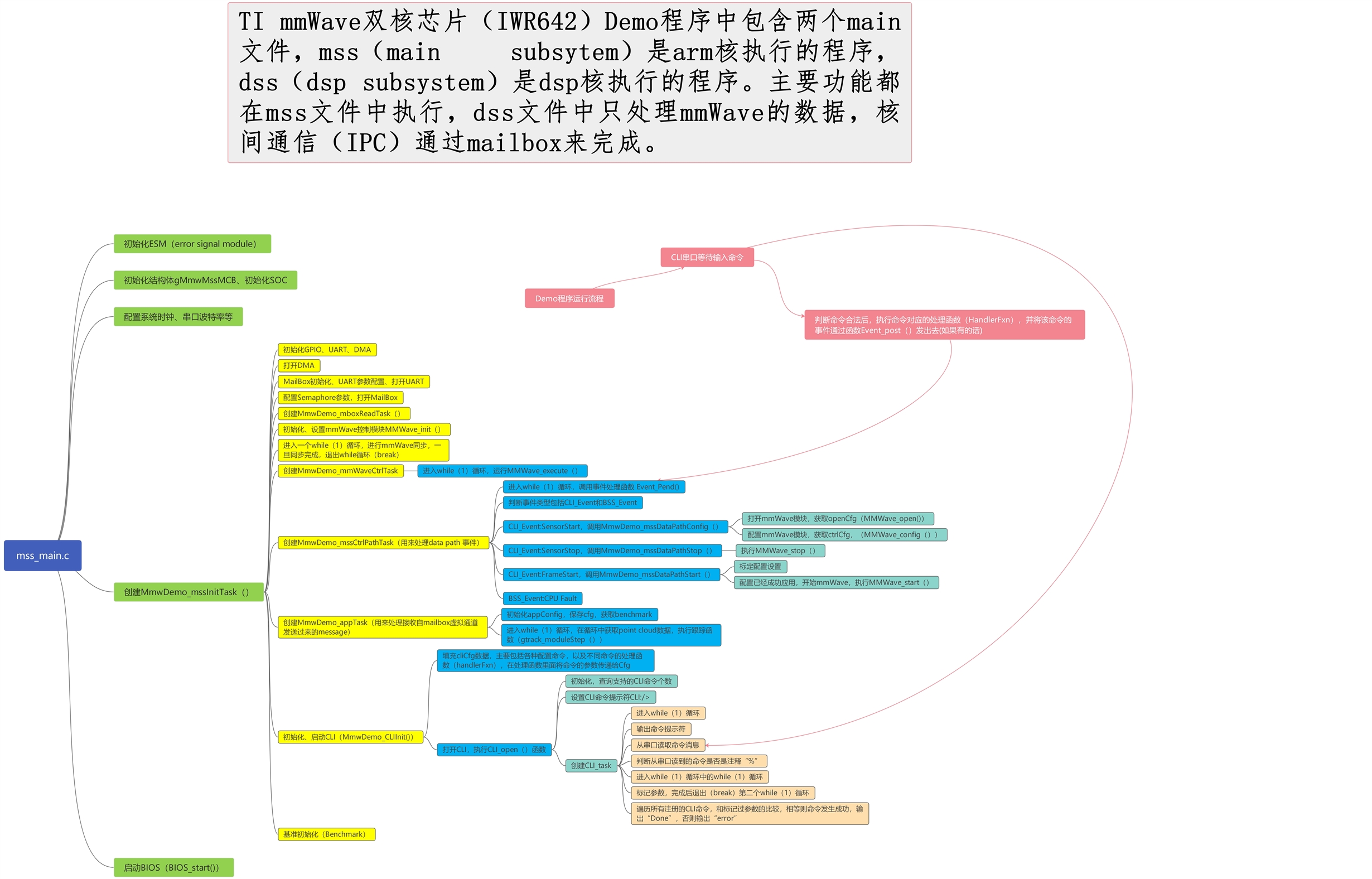

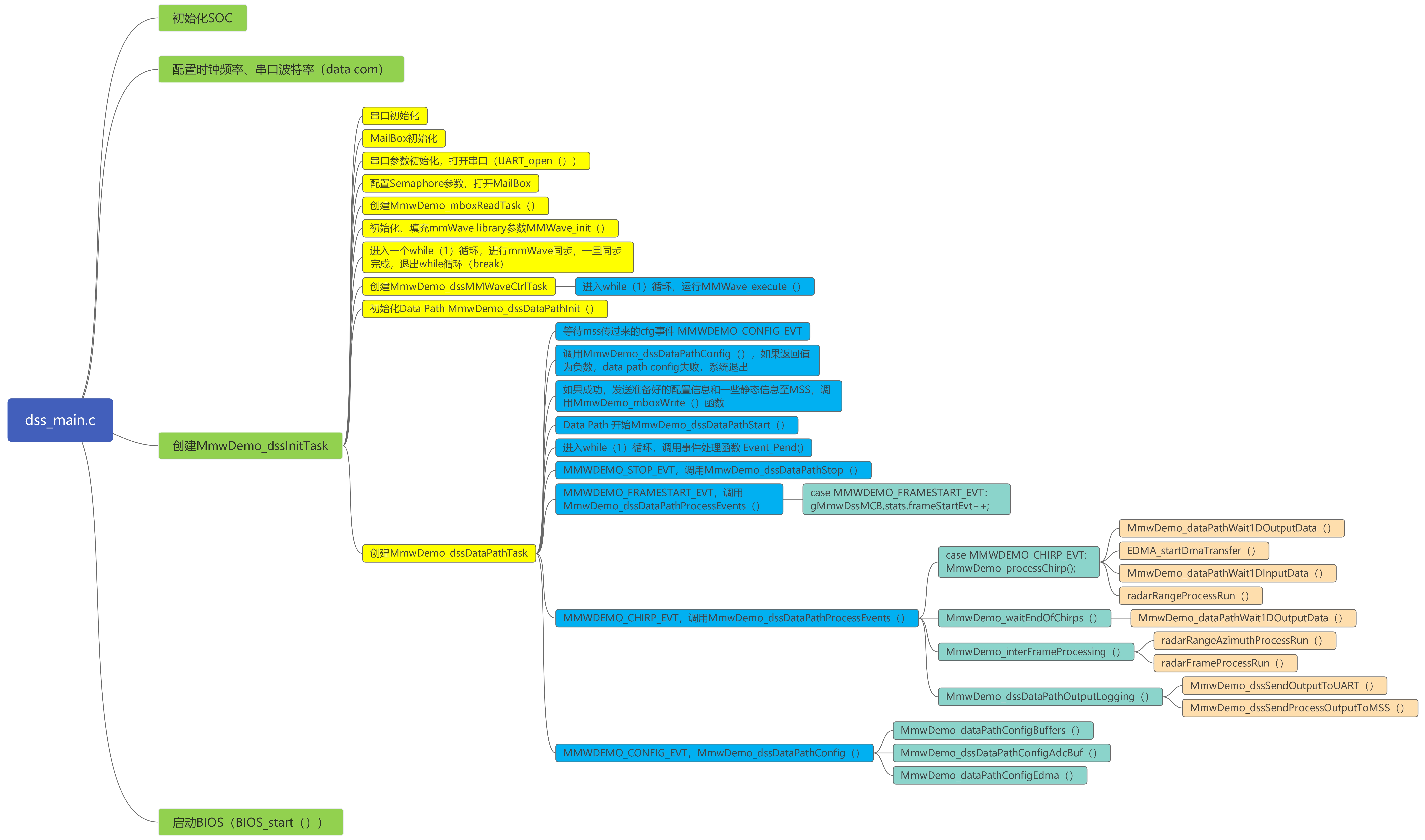

I am a member of the elevator insdusty. I saw a article on WeChat that introduced people counting based on mmWave technology applied to elevator system for group control.
I am very interested in it. So I bought a IWR1642Boost EVM for developemt. I also concluded the people counting demo code flow char and data struture which the file is attached.
