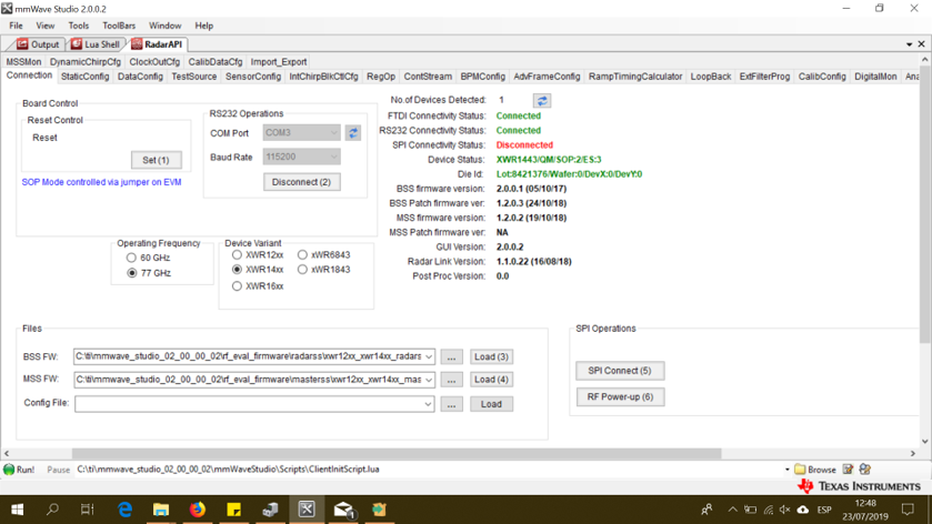

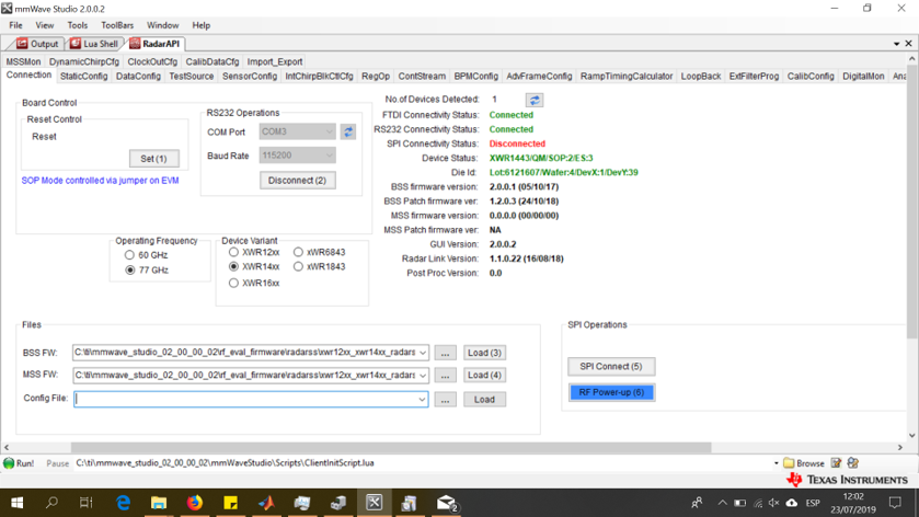

I have a problem using AWR1443BOOST (ES3, there is an FC on my chip) and DCA1000EVM on mmwaveStudio. It seems like the MSS firmware can not be downloaded and SPI connection is not successful. I looked at several e2e forum threads which reported the same problem, but their solutions and suggestions did not work.
Jumpers position is correct. And the cables I am using work on another board (AWR1648BOOST) and with my AWR1443BOOST out of mmwaveStudio.
Runtime 8.5.1 downloaded. Visual Studio Downloaded.
I tried two different power supplies in case it was a current limitation, it was not.
I also checked with another HD 60pin of a board that works (AWR1648). Mine didn´t, the other one did.
I tried version 2.0.0.2 and 1.0.0.0 of mmwave Studio and it did not work.
I also used rf_eval_firware from both mmwave Studio versions on both versions and different combinations. The result was still unsuccessful.
We checked if it was a problem with my computer and tried it on another one which connected the AWR1648, it didn't work.
We checked the AWR1648 board on my computer and it worked (no problem with my computer).
