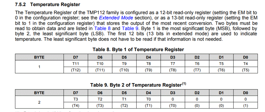

We have EEPROM and TMP112 on IWR6843ISK and IWR6843ODS board. Could you please provide the reference code to read these sensor value through IIC?
Thanks.
  • Wesley,
         In the current version of the demos, this interface is not developed.
    Hence there may not be a reference code available, However you may want to read the temperature register in the TMP112 as shown below.
