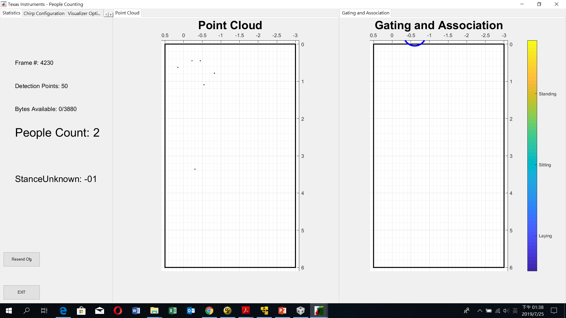

the test  room is about 2 meter width and 3 meter long, the device is put left corner about 2 meter high.
as above diagram, the Gating and Association diagram always show the people position close Y-axis zero point
if I walk away from the device in the Y-axis, the circle will disappear,
anyway the circle always stay close to Y-axis zero point, if I doing any wrong about this lab settings?
my scene parameter setting is SceneryParam -2.08 0.1 0.5 2.9 -2.06 0.36

  • Hi KuangMing,
    This GUI displays X and Z coordinates.So when you walk away it looks like your Z is becoming negative and going outside of the bounds of the GUI.  Your Scenery Parameters are good for the position of the sensor.
    If you have Matlab, you can modify the GUI to display X and Y coordinates.
