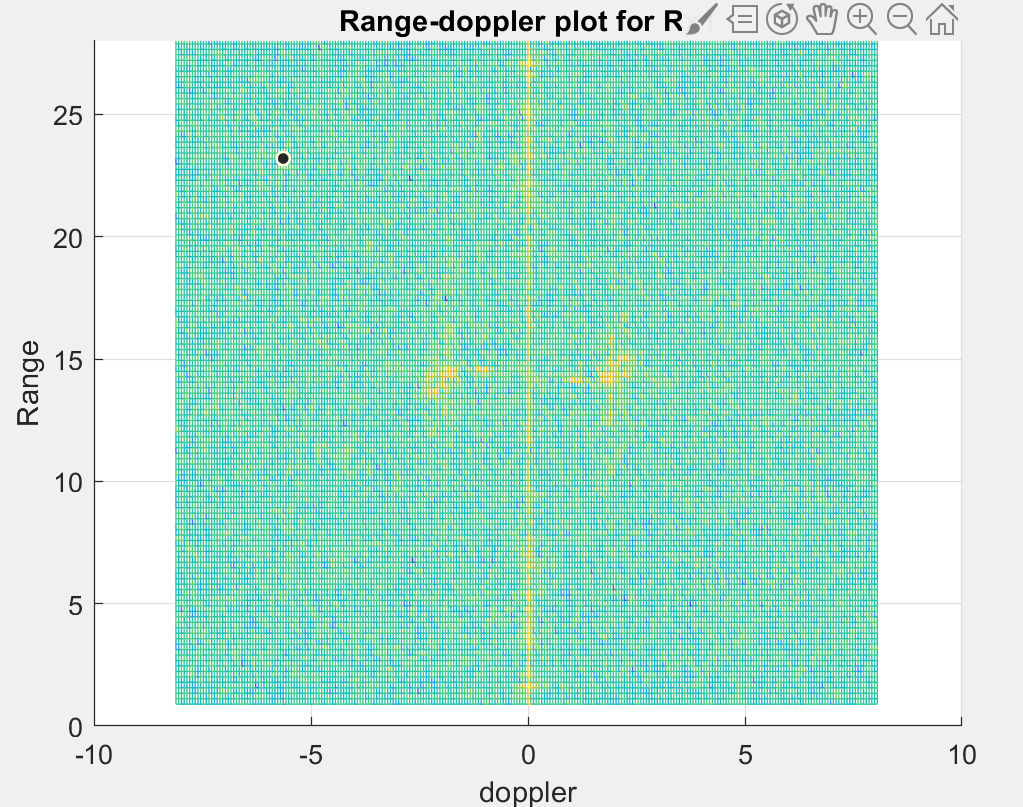

I found my 2DFFT results have some symmetric patterns which should be wrong according to the post processing results of mmwave studio.
Let's see an example. This 2 images are 2DFFT result from same complex data which is captured by DCA1000 and AWR1642. The left one is what I plot and the right one is what mmwave studio plot.
At approximatelt 15m, there are two doppler patterns in the left image, however there is only one positive pattern in right figure.
I don't know why my code would generate this error and it seems your matlab code is more robust. Do you hava any idea of how to solve this problem?

    Could you post your configuration and code (pseudo) of the script?
    Jitendra
  • Sure!
    The configuration is shown below. And the matlab pseudo code is something like:

  • Thanks,
    I solved  this problem. It is because I read dca1000 functoion was wrong. I used the new function in fiile 'Mmwave Radar Device ADC RAW data capture' and it works now.
