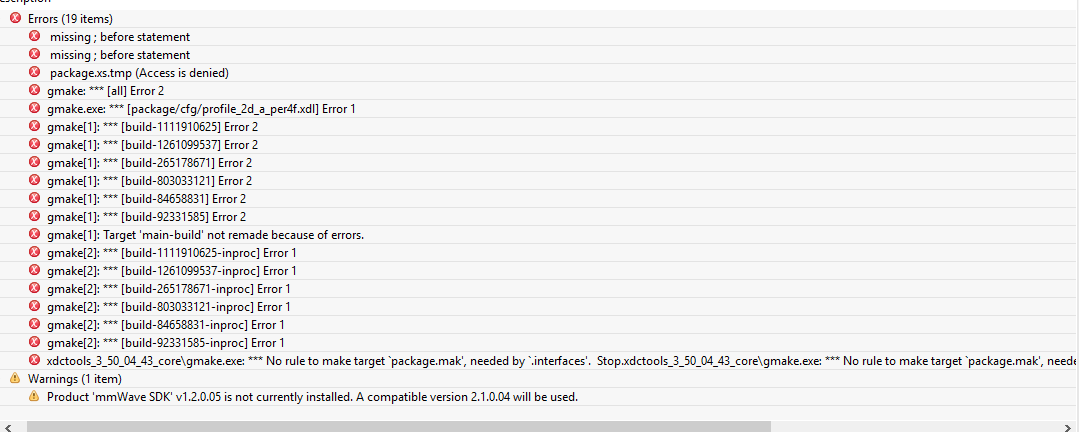

The next thing I tried was to use the high accuracy demo to target a specific object. However, the demo would not build and I got a plethora of errors as shown below:
Because of these errors, I decided to try and port the code over to the SDK demo and get the data from there. I managed to get the code over and build with no errors. I then edited the config file to accommodate for the range boundary configuration. I finally ran this code and got a runtime error that I don't know how to fix. The error is below:
If I could get a solution to any of these three approaches that would be great. All I need is to get the data from a single object and it's definitely not as simple as I thought it would be.

  • I'm using ES3.0 so I figured that was the issue there. In another forum post about this you said that the solution was to port over the code which is what I attempted to do but got the errors in the second image I posted. Do you know how to fix this error?

  • Hi Daniel,
    Unfortunately it is difficult to know why you are seeing these errors because I haven't seen your code, if you post what is at line 2251 I may be able to provide some insight but it will be difficult for us to provide a full code walk-through at this time.

  • The code at line 2251 is simply a debug statement as shown in the attached image.
