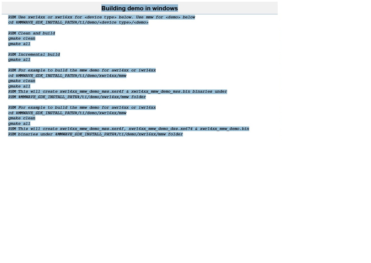

CCS/IWR1642BOOST: I am not able to re-build cli library using gmake of demo code.
Part Number: IWR1642BOOST
I am doing this process to load config parameter automatically without use of demo visualizer.I am trying this step by step  after pasting cli.c file in C:\ti\mmwave_sdk_02_00_00_04\packages\ti\utils\cli\src. I  tried to rebuild cli file using gmake but it  gives me this.
C:\ti\mmwave_sdk_02_00_00_04\packages\ti\demo\xwr16xx>gmake clean
'gmake' is not recognized as an internal or external command,
operable program or batch file.
C:\ti\mmwave_sdk_02_00_00_04\packages\ti\demo\xwr16xx>gmake all
C:\ti\mmwave_sdk_02_00_00_04\packages\ti\utils\cli>gmake clean
C:\ti\mmwave_sdk_02_00_00_04\packages\ti\utils\cli>gmake all
I am doing this as per describe in sdk user guide.Am i right ?
  • Hi Arpit,
    As mentioned in the SDK user guide, You need to run setenv.bat (under packages\scripts\windows) as the first thing in the command session to set the required environment variables.
    -Nitin
