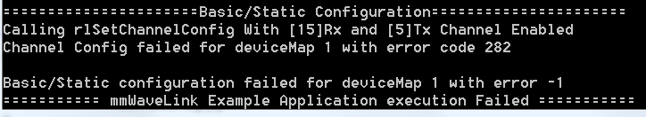

This time, I used a AWR1243P booster board design and tried to set the cascading parameter rlUInt16_t cascading to 1 (MULTICHIP_MASTER) using
the example codes from mmwave_dfp_01_02_00_01\ti\example\mmwavelink_example.
The same problem occured:
the error code is 282: <Device variant does not allow cascading but API is issued to enable cascading mode>
I am using a AWR1243P chip which should support cascading design.
Could some explain how to solve this problem?
