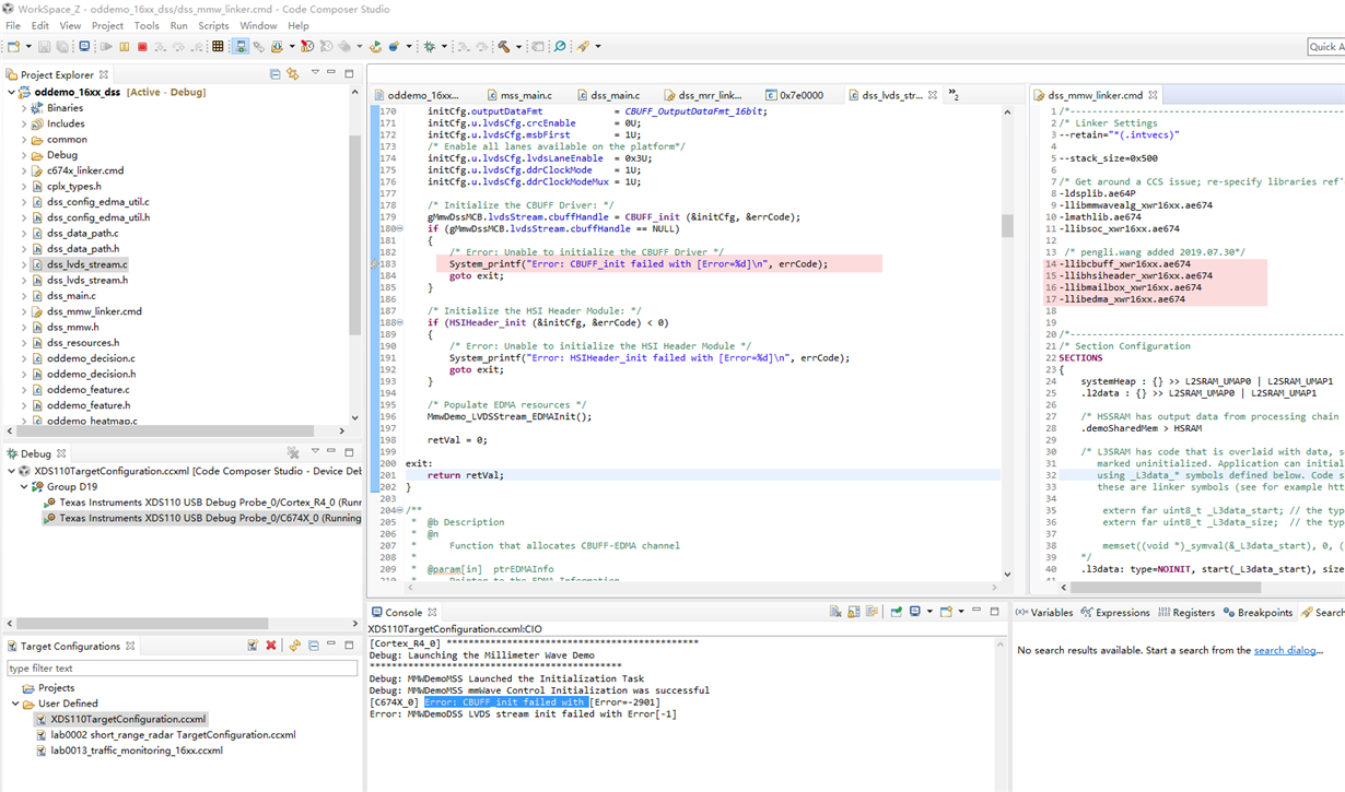

we're working on the lab0003_occupancy_detection_ES2.0 ccs project based on SDK2.0.0.4 . We'd like to caputure the lvds data from the 60-pin interface meanwhile the mss output the heatmap data via uart .
so we modify the ccs project settings and add "dss_lvds_stream.c" and "dss_lvds_stream.h" files into the ccs project .

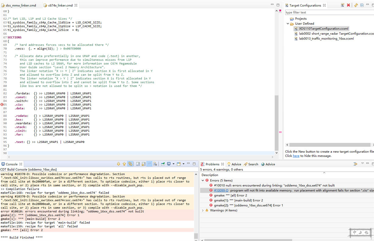

however we got "error #10099-D: program will not fit into available memory.  run placement with alignment fails for section ".cio" size 0x127" shown below

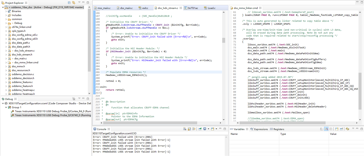

then we redit "dss_mmw_linker.cmd" file

after this , we got "Error CBUFF_init faild with [Error -2901]"  means  Invalid argument and we find that initCfg.socHandle  can not get value from gMmwDssMCB.socHandle .but we don't have any ideal what cause this problem.
Is that possible that "dss_mmw_linker.cmd" modify caused the problem?
Do you have any advices ?
Simon

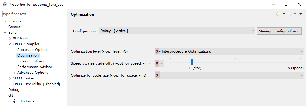

  • Simon,
    Since the amount of code that the linker was unable to allocated was 0x127, you should try lower the "speed vs. size" optimization level down and see if the linker for the C6000 is able to run correctly with these settings. This is a relatively small amount of code that is missing allocation.
    Kyle
  • Hi Kyle , thanks for your reply .
    I have tried to modify the optimization level  but it seems that it doesn't work . I still got the same error "Error: CBUFF_init failed with [Error=-2901]  Error: MMWDemoDSS LVDS stream init failed with Error[-1]"
    Simon

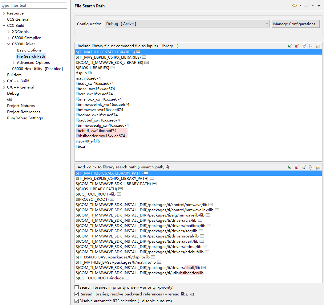

  • Simon,
    Since you are using a lab from the TI Resource Explorer, let's make a few changes to the .projectspec file for the DSS project of the Occupancy Detection Lab.
    Since you are looking to include the CBUFF drivers for LVDS, let's make the following change in the "linkerBuildOptions" section
    -I${COM_TI_MMWAVE_SDK_INSTALL_DIR}/packages/ti/drivers/cbuff/lib
    -llibcbuff_xwr16xx.ae674
    This will tell the linker that you are including the cbuff driver and where this file is located.
    Now since you are making some specific changes as to where some of the initialization functions are being allocated, you should keep the following line included at the top of the dss_mmw_linker.cmd file.
    You will need to repeat this process for any additional drivers that you want to include in your custom project. It is easiest to make these changes to the .projectspec file and then import the lab into CCS.
    Kyle
  • Kyle,
    All these changes you mentioned above  have been made before.
