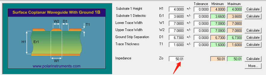

    Thanks for your reply, I don't  fully understand what you last sentence. I use polar Si9000 compute 50ohm waveguide strips, as follows
    The impedance information I calculated based on the parameters of AWR1243BOOST, but it does not involve the diameter and spacing of the via around the TR antenna.
    So, how can I simulate the trace impedance with the vias? What tools are used to simulate trace impedance with the vias?

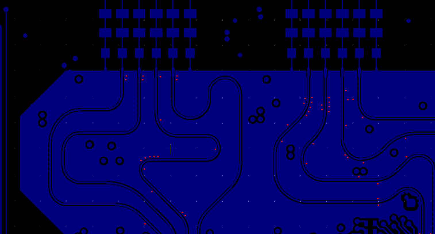

    in addition, I see in mmWave Cascade Radar RF Board (four AWR1243P cascade), The blind vias around TR antenna of  Cascade Radar RF Board are not as dense as those around AWR1243BOOST,
    The blind vias in Cascade Radar RF Board  are shown below in the red dots, Why this RF Board does not need many continuous via around the TR antenna?

    You can use EM simulation tools like HFSS to simulate the impedance with the board layout. At 80Ghz the polar calculator may not be accurate.

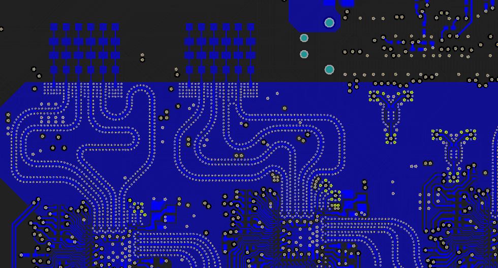

    Regarding the via spacing on the cascade RF board, the image you shared does not seem to be enabling the 1-2 vias. Below is the image of the cascade RF board. You can see that the 1-2 GND vias are very closely spaced all along the RF trace.
