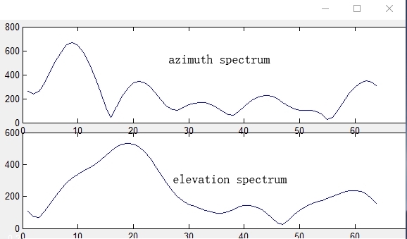

In theory, I can understand 'An FFT of the above signal will yield a peak  P2 at Wx', but the real situation is not so.I will show some  acquisition data in the bellowing:
From the figure above, we can see that the positions of the max peak point are different for the aimuth and elelvation spectrum.Doppler compensation is not done in the test, is this the reason for the  difference?

    1) Why do you expect the max peak point to be the same for both elevation and azimuth spectrum? They should be different based on the target orientation, right?

    For the first question, I also have some doubt. According to the FFT property two sequences such as Ae^(jw0)[1,e^(jw), e^(2jw),e^(3jw),e^(4jw),e^(5jw),e^(6jw),e^(7jw)]  and  Ae^(jw0)[1,e^(jw),e^(2jw),e^(3jw)] are  performed by FFT with N points,the peak points for the two sequences should be the same,such as the 3th point. I think it is reasonable the max peak point should be the same for both elevation and azimuth spectrum.

    I finally understood your question. The two FFTs (of the 'top row' of virtual antennas, and the 'bottom row' of virtual antennas) should be the same. The fact that they aren't implies that there is some mismatch between the antennas - Have you done a zero-angle calibration?

        For the first question,my understanding is as follows: If I do zero-angle calibration,the two spectrums should be the same, is that right? I have another question, I consider that zero-angle calibration  means Range Bias and Rx Channel Gain/Phase Measurement and Compensation, is it right?
