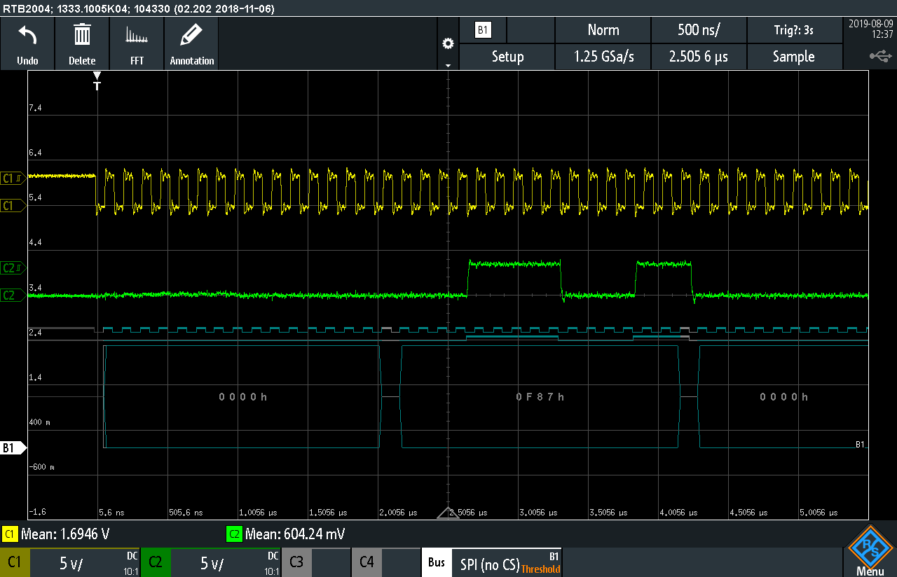

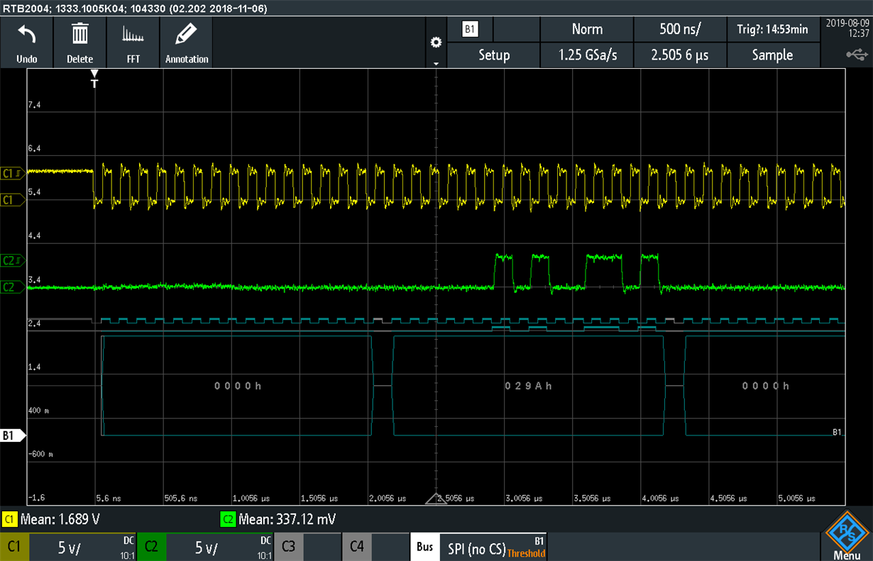

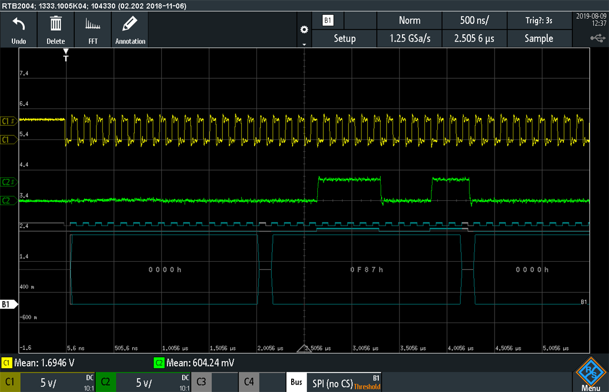

Taken a look into the bare SPI communication it looks as follows:
TIME1 is OK, value is 0x29A:
TIME1 is NOT OK, value is 0xF87:
This happens approximately 1 out of 10 times. TIME1 then always has 0x0Fxx, where as 0x02xx would bring the value to a reasonable area.
It seems to me, that the second byte of TIME1 (bits 8 - 11) are corrupted by the TDC somehow. I have no idea how to explain that otherwise. Or am I missing a point?

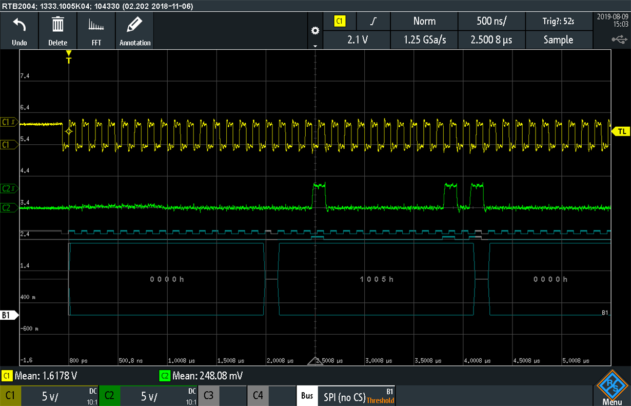

EDIT:
I found cases where TIME1 has not 0x0Fxx but 0x10XX:
I also checked the 16MHz clock of the TDC and it looks fine. No glitches or noise on the clock.
Cheers Benjo

    I have checked the Timex registers using our TDC7200 EVM and I am unable to recreate the scenario wherein the Time1 register is around 3.5 times the sysclock.
    Also as in Figure 18 in datasheet: TIME1 is occurrence of START edge to first clock edge. TIME2 is occurrence of STOP edge to next clock edge. So if your Time 1 alone is cyclic then ti could be due to the change in START happened closer to first clock edge. Note that the clock timing and your signal timing will be in sync always and that can create this changes.

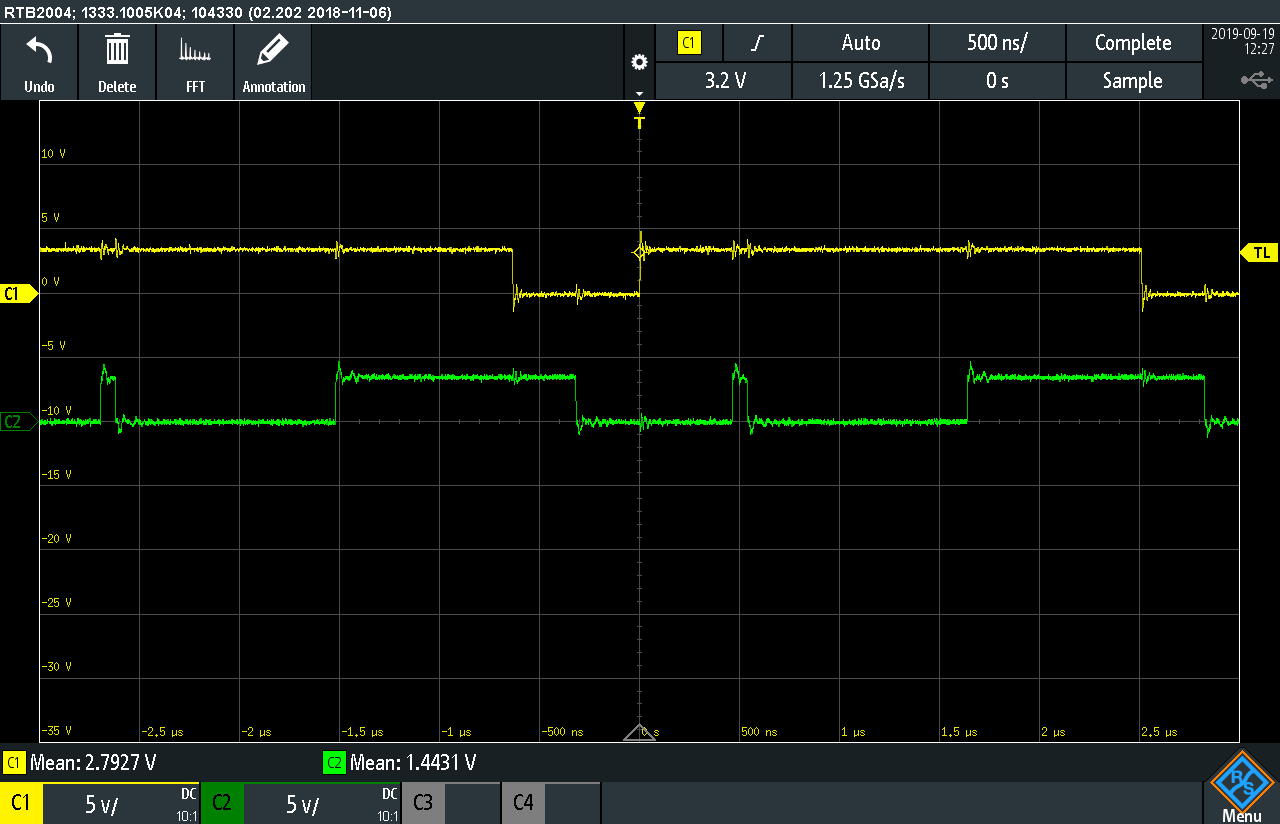

  • As already stated, we configured the TDC7200 to wait for two stop signals and use measurement mode 2. Now the problem comes in - the first is just under 500ns, the second is ~1.7us.
    what mesurement mode would you recommend in this case? You think this could cause the problem?
    I'll try to shift the first stop signal beyond 500ns in the meanwhile and let you know.
    UPDATE:
    I shifted the first STOP signal beyond 500ns to ~800ns. The issue remains the same. In this case the TIME1 must clearly not have a value > 1 clock period.
    I also want to note again, the too large TIME1 values happen only approximately 1 out of 10 times. So if it would be the wrong measurement mode, I would assume TIME1 would be affected every time.
