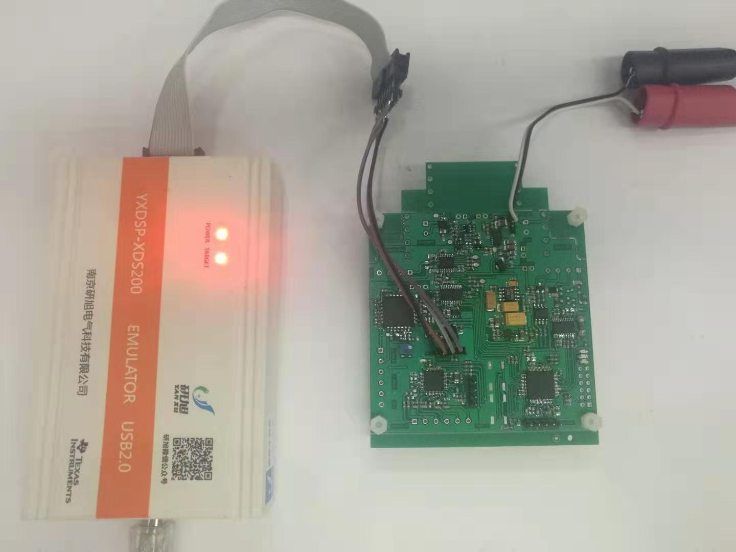

Self-designed PGA970 board
Code Composer Studio  7.1.0.00016
YXDSP-XDS200 Emulator
PGA970 Reference Firmware from www.Ti.com
OS: win10 home edition(64bit  x64) / win10 Professional edition(64bit  x64)

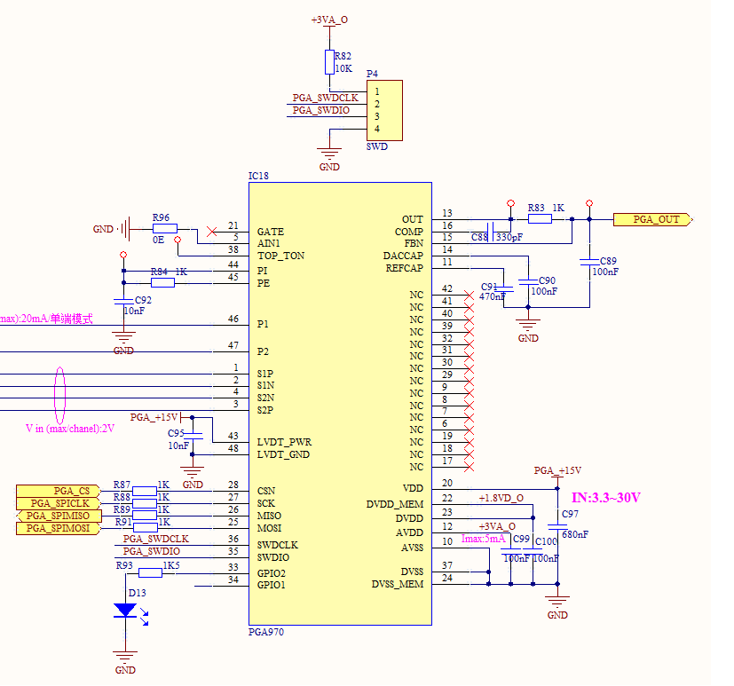

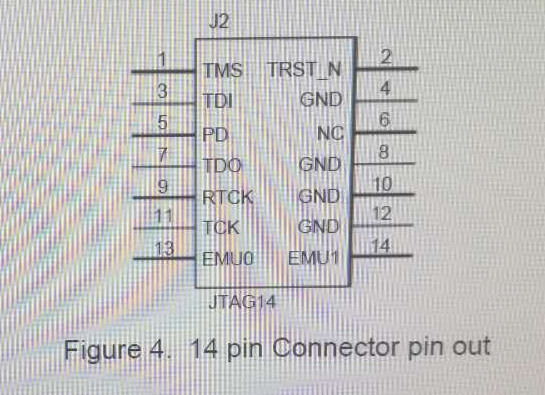

SCH is the following: SWD is a four-pin connector
Connection diagram is the following:
XDS200 14-pin Connector
PGA970 Board 4-pin connector
PIN1: VCC_3
PIN2: SWDCLK
PIN3: SWDIO
PIN4: GND
TMS(XDS200 pin1)  ----  SWDIO(PGA Board pin2)
TCK(XDS200 pin 11)  ----  SWDCLK (PGA Board pin3)
GND(XDS200 pin4)  ----  GND(PGA Board pin4)
PD(XDS200 pin5)  ----  VCC_3(PGA Board pin1)

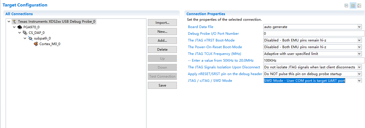

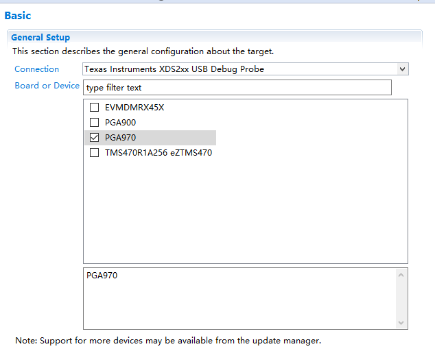

CCS Configuration

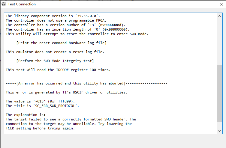

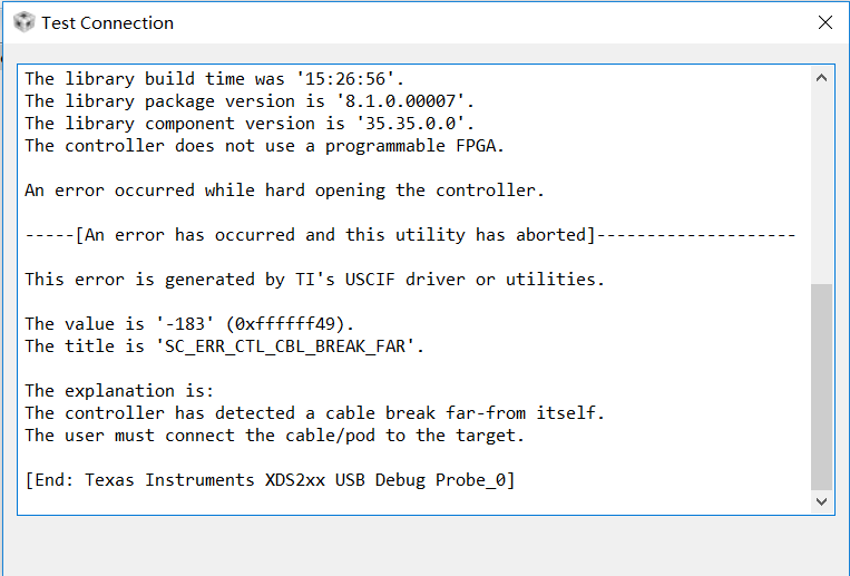

Error Information:
computer with win10 home edition:
computer with win10 Professional edition:
I try many many times , but the result still does.
In the computer with  Win10 home edition, PGA970 board can be connected at very low probabilities (about 1/20), and In the other computer with win10 professional edition, PGA970 never can be connected.
