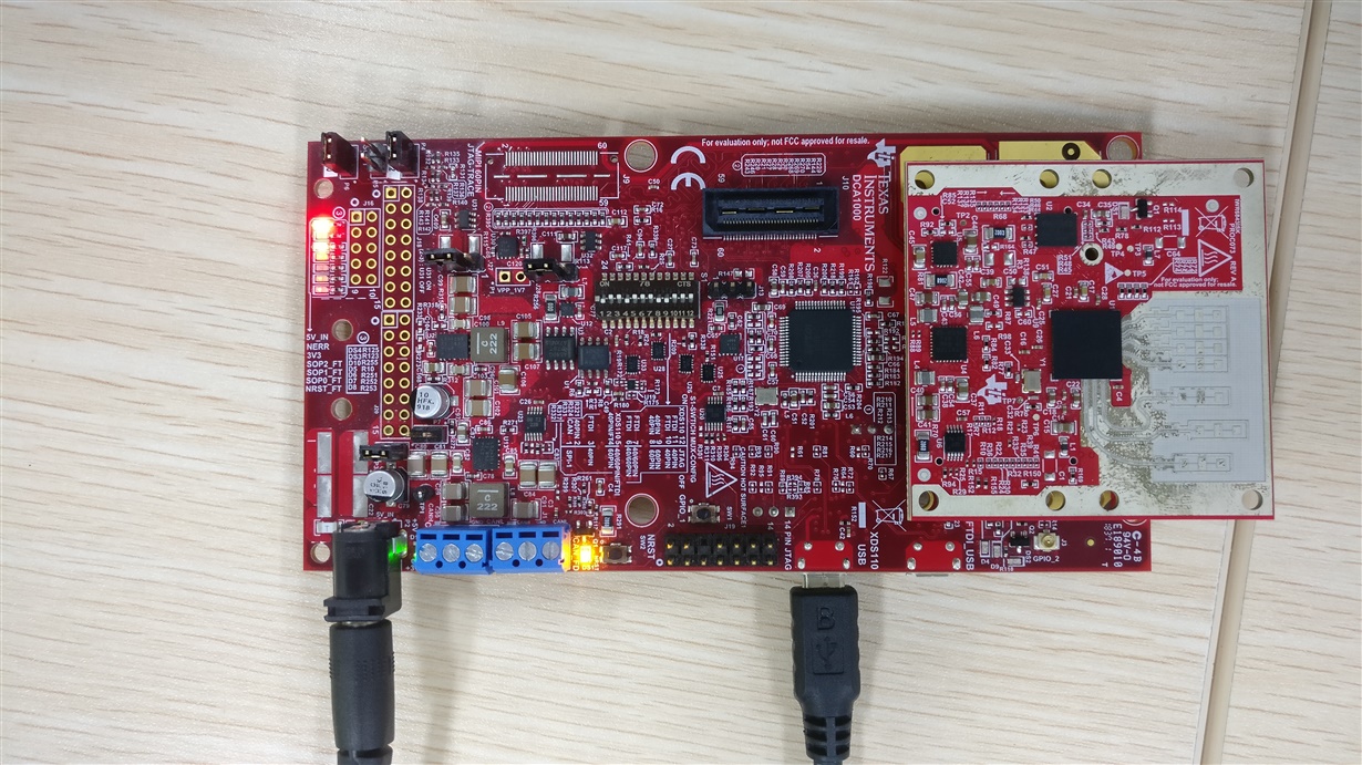

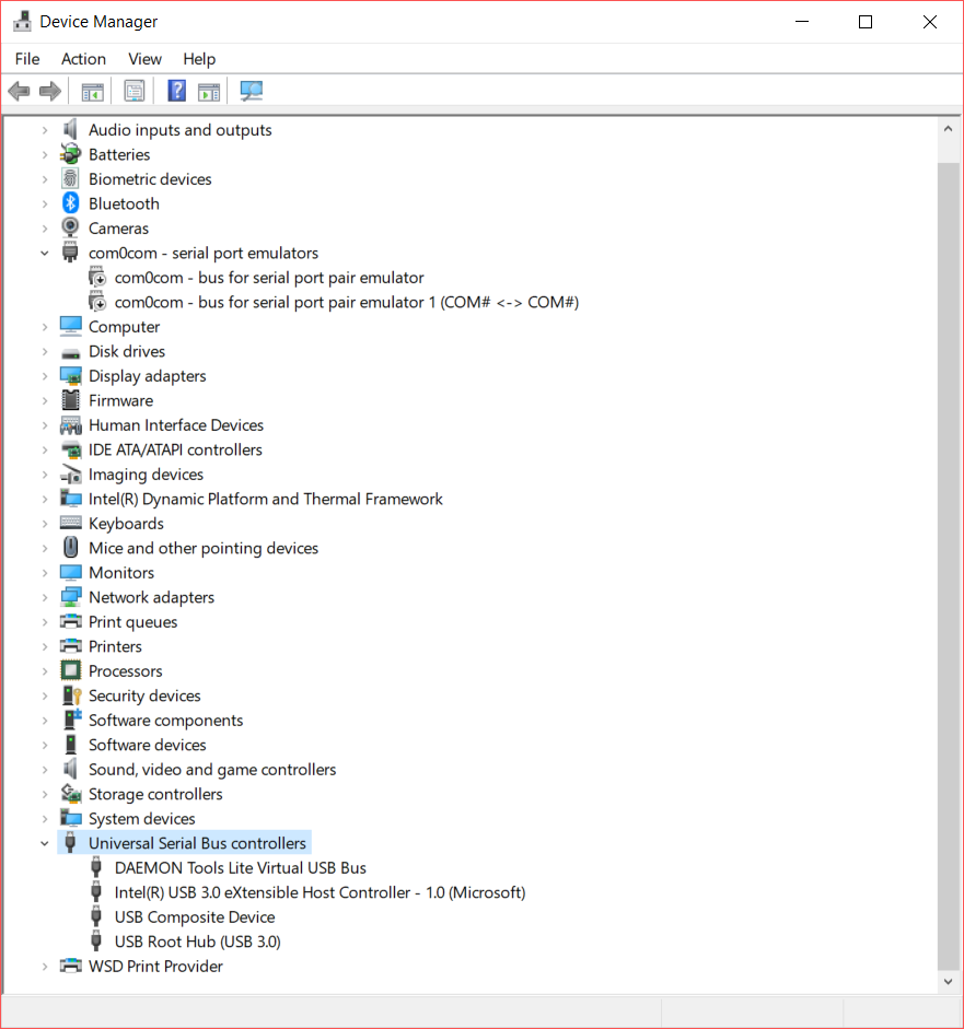

While attempting to start a demo on the IWR6843ISK Evaluation Module with MMWAVEICBOOST, the ports that correspond to 'XDS110 Class Application/User UART' and 'XDS110 Class Auxiliary Data Port' is not detected. I cannot flash any firmware using UniFlash as there is no COM port detected. DS1 on the IWR6843ISK antenna is also not lit up when the power is on.
Is this a hardware issue? I am using Windows 10 and have attached pictures of my setup.

It doesn't look like your board is properly powered, LED DS1 should be lit. Please confirm that you are using a 5V/3A power supply and the IWR6843ISK is properly mounted.

I used a lab DC power supply unit (Rigol DP832) to give an output of 5V, but only a current of 0.1A is drawn and the LED DS1 on the antenna is not lit.
I suspect it could be a damaged IWR6843ISK board.
Was this board broken out of the box or it worked for while?

The board was working out of the box, but it was shelved for a couple of weeks before trying it out again.
You will need to troubleshoot the board. Can you check the power rails to ensure you are getting the right voltage levels?

I have ordered another board and the new board is working well. Maybe the old board just became faulty after a while.
