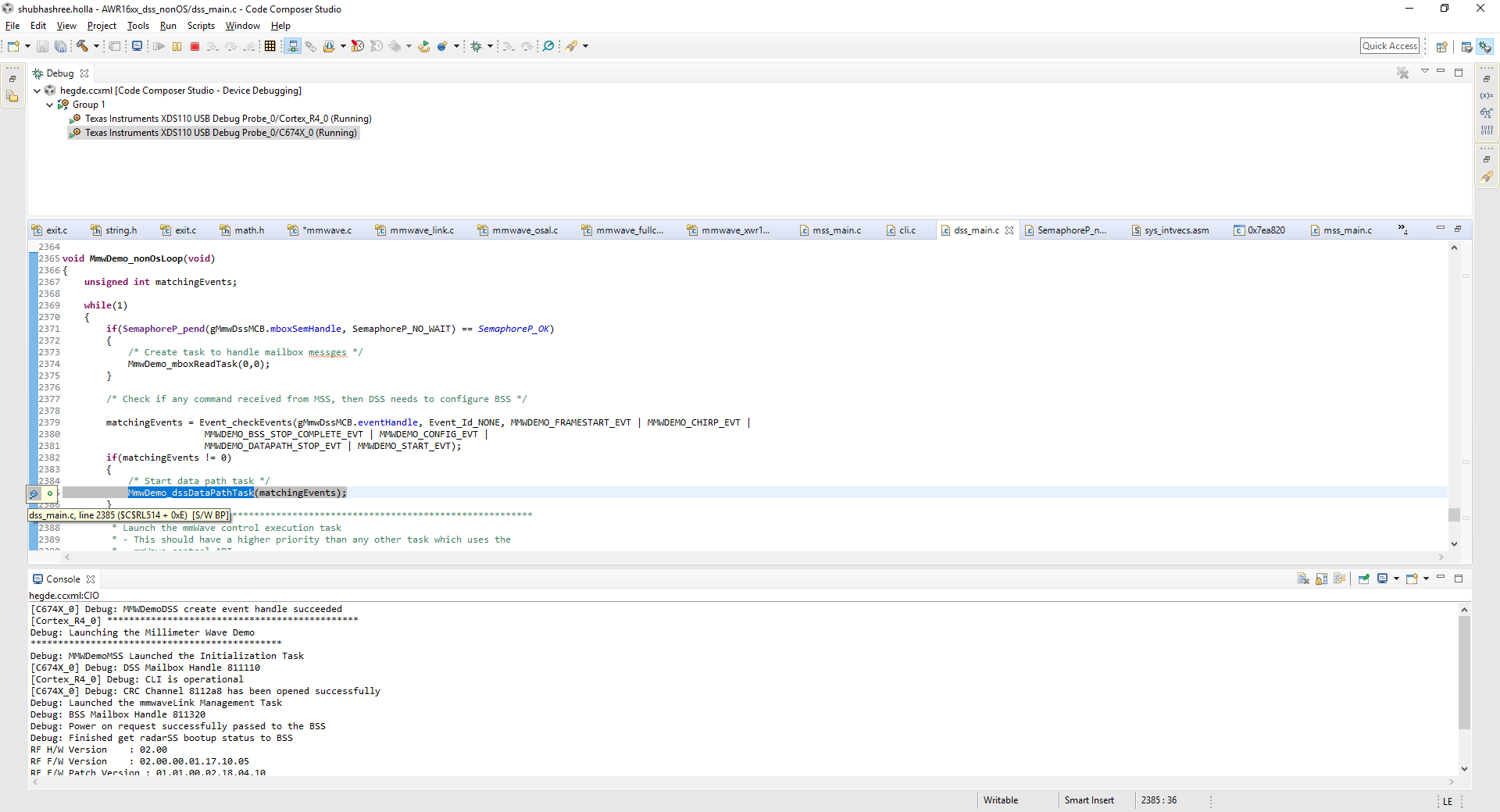

I use AWR1642 and tried to compile with no optimization of NonOS projects for dss and mss subsystem
Both projects compiled well without any issues
Then i launched my own target configuration file and loaded the compiled code into dss and mss subsystems.
Then i ran MSS first and later dss freely
Now i kept a break point at MmwDemo_dssDataPathTask function called in MmwDemo_nonOsLoop function of dss_main.c file.
I could not get any events and could not hit MmwDemo_dssDataPathTask. looks like there are no events coming
Can TI help on this?
I got the below messages in the console when i ran both dss and mss freely
[C674X_0] Debug: MMWDemoDSS create event handle succeeded
[Cortex_R4_0] **********************************************
Debug: Launching the Millimeter Wave Demo
Debug: MMWDemoMSS Launched the Initialization Task
[C674X_0] Debug: DSS Mailbox Handle 811110
[Cortex_R4_0] Debug: CLI is operational
[C674X_0] Debug: CRC Channel 8112a8 has been opened successfully
Debug: Launched the mmwaveLink Management Task
Debug: BSS Mailbox Handle 811320
Debug: Power on request successfully passed to the BSS
Debug: Finished get radarSS bootup status to BSS
RF H/W Version : 02.00
RF F/W Version : 02.00.00.01.17.10.05
RF F/W Patch Version : 01.01.00.02.18.04.10
mmWaveLink Version: 01.01.00.05
Debug: MMWDemoDSS ADCBUF Instance(0) 8105c0 has been opened successfully
Debug: MMWDemoDSS Data Path init succeeded
