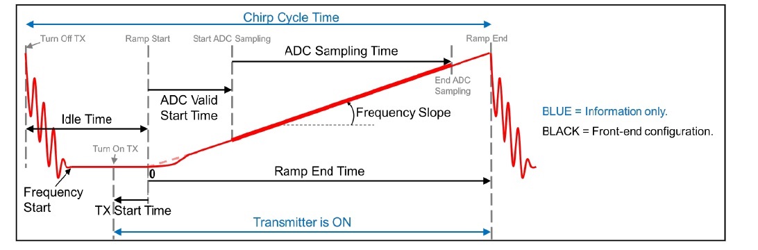

  • Hi Jitendra,
    Thank you again for your advice.
    Well, I am aware of sawtooth and triangular waveforms and the concept of negative frequency slope which implies a decreasing frequency but thank you for the refresher.
    My query was based on the following famous widely used TI figure.
    From the above figure, I (possibly wrongly) assumed three things about the TI mmwave devices:
    1)  TI mmwave devices can only generate sawtooth waveform chirps (with ONLY positive frequency slopes)
    2)  TI mmwave devices cannot produce sawtooth waveform chirps with negative frequency slopes.
    3)  TI mmwave devices cannot produce triangular waveform chirps having (possibly) equal  (or unequal) positive and negative frequency slopes.
    In you message of 23rd August, you stated that frequency slope CAN have negative value,
    This information is very important and rather eye-opening for me as it was contrary to my assumption based on above TI figure.
    I am sure that certain other users might be having same supposition.
    Therefore, I request you please explicitly negate or confirm the following statements:
    1)   TI mmwave devices can produce sawtooth waveform chirps with negative frequency slope.
    2)  TI mmwave devices can produce triangular waveforms with equal positive and negative frequency slopes.
    3)  Can TI mmwave devices produce asymmetrical triangular i.e. waveforms with unequal positive and negative frequency slopes.
    Apart from that, i will try to reproduce imaginary scene scenarios to obtain negative Chirp Configuration Parameters from mmwave Sensing estimator Tool and if I succeed, I will share those details with you .
    Thank you.
  • Hi Alper,
    Picture provides the pictorial explanation of default use-case of mmwave sensor usage. However -ve slope and triangular will be an advanced use-case.
    1) mmwave sensor supports negative frequency slope to produce sawtooth waveform chirps.
    2) Triangular waveforms can be achieved with mmwave sensor with equal positive and negative frequency slopes (but with little gap b/w these two slope). In this case, there will be two type of chirp adjacent to each other, first one connected to profile-1 (+ve freq slope) and second chirp is connected to profile-2 (-ve freq slope), where idle time for 2nd chirp required in b/w of +ve and -ve slope chirps.
    3) Based on 2nd answer, slope is based on the profile to which that chirp is connected to. So it can have an equal or un-equal slope.
    Jitendra
