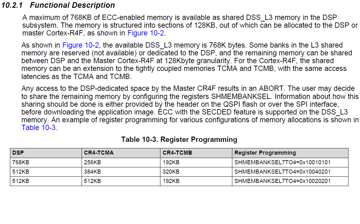

  • Hi, Dave.
    Sorry to say that I don't understand.
    Please check 10.2 DSS_L3 MEmory Organization for 16xx on TRM(swru520c).
    The thing that I understand is.. it is possible to change the size of TCMB to 320KB from 192KB.
    Please check that document content.

  • I understand above comments as..
    It supports 320KB CR4-TCMB.
    Please share the meaning of that above comments on TRM.

  • You mean it is available,
    could you share how to get that 320KB TCMB?
  • Hi Minan,
    I have been looking into this as time permits, and while it is possible, it requires expert knowledge and requires rebuilding tools that we currently do not provide the source code for.  Until we provide a procedure and tools for doing this at the customer level, I would suggest looking into alternatives:

  • Hi Minan
    Give me a day or so to look into this. The steps you did should have worked and yes the MPU settings seems to be incorrect in the release (will file an internal bug). With shmem_alloc set to 0x00010005 and MPU setting fixed, if you keep the TCMB used space to be less than 192KB, does the device/application boot-up normally? if yes, then could you connect CCS and see if you can access TCMB beyond the 192KB space using Memory browser in CCS?
    Thank you for your patience,
     Madhvi
  • Hi Minan
    These are the experiments I did and after just fixing the MPU bug, I was able to use the extended TCMB memory.
    • Step 1: Fix SOC_mpu_config to set the SOC_MPU_REGION3 size to SOC_MPU_512_KB
    Setup region 3, TCMB DRAM, base address = MSS_TCMB_BASE_ADDRESS, size = 512 KB (actual 192 KB + optional 128KB extension),
    Access Permissions: Full Access
    Execute Permissions: Execute Never
    Memory Type: Non-Cached, Non-Shared, Normal
    #if ((SOC_XWR16XX_MSS_TCMB_BASE_ADDRESS & (512U * ONE_KB - 1)) != 0)
    #error SOC_XWR16XX_MSS_TCMB_BASE_ADDRESS not aligned to 512 KB
    #endif
    SOC_MPUSetRegion(SOC_MPU_REGION3);
    SOC_MPUSetRegionBaseAddress(SOC_XWR16XX_MSS_TCMB_BASE_ADDRESS);
    SOC_MPUSetRegionTypeAndPermission(SOC_MPU_NORMAL_OINC_NONSHARED, SOC_MPU_PRIV_RW_USER_RW_NOEXEC);
    SOC_MPUSetRegionSizeRegister(SOC_MPU_REGION_ENABLE | SOC_MPU_512_KB);
    • Step 2: rebuild SOC driver and ccsdebug with environment variable MMWAVE_SDK_SHMEM_ALLOC set to 0x00010005 (all other environment variables and build instruction same as SDK User guide)
    • Step 3: Verify map file and see the TCMB size go up to 0x50000 and L3 reduced to 0x000a0000.
    • Step 4: Burn this new ccsdebug to flash and bootup AWR1642
    • Step 5: Connect CCS to R4F core and View->Memory Browser. Check access to TCMB address space using following addresses (just examples):
      • 0x08000000
      • 0x08000000 + 0x00040000 - 0x4
      • 0x08000000 + 0x00050000 - 0x4
    • Step 6: Created global variables in ccsdebug utility, placed them in a distinct section (.extMem) and used (HIGH) keyword in linker command file to place them in top section of extended TCMB.

    • Step 7: rebuild ccsdebug with environment variable MMWAVE_SDK_SHMEM_ALLOC set to 0x00010005. Verify map file that .extMem is 8 bytes long and placed at 0804fff8.
    • Step 8: Burn this new ccsdebug to flash and bootup AWR1642
    • Step 9: Connect CCS to R4F core. Check address and value of clkCfg and socHandle in expressions window.
    So all the above steps were succssful and working at my end i.e. application could leverage the extended TCMB region. You could also try those in your setup using SDK's ccsdebug and let us know the outcome.
