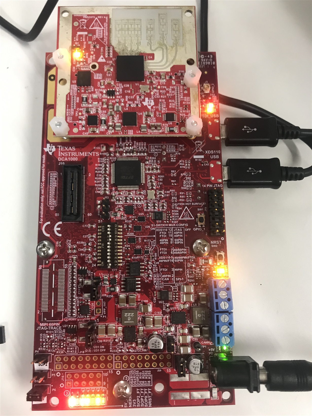

Board: MMWAVEICBOOST + IWR6843ISK EVM

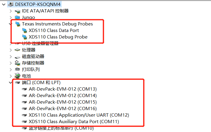

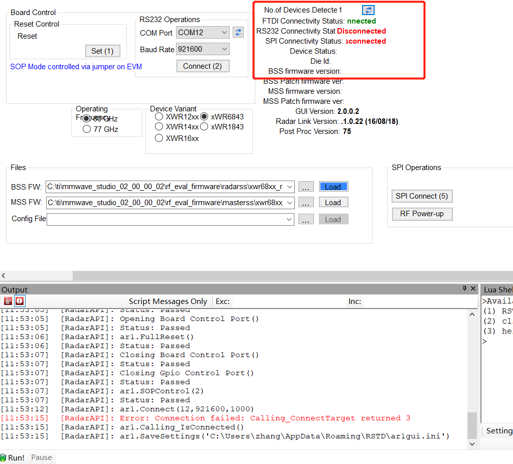

Customer followed the user guide, but RS232 is not connected when using the Radar API of mmWave Studio.
The serial ports are connected, and the corresponding 6 serial ports are displayed on the computer. The customer saw there were 8 serial ports in the data sheet, but why he only has 6?
  • Hi Annie,
    Please make sure your customer is closing the device manager and any other application that could be accessing this com port.  Also, make sure your USB is connected directly to the computer- some USB splitters are not compatible.
    -Chloe
