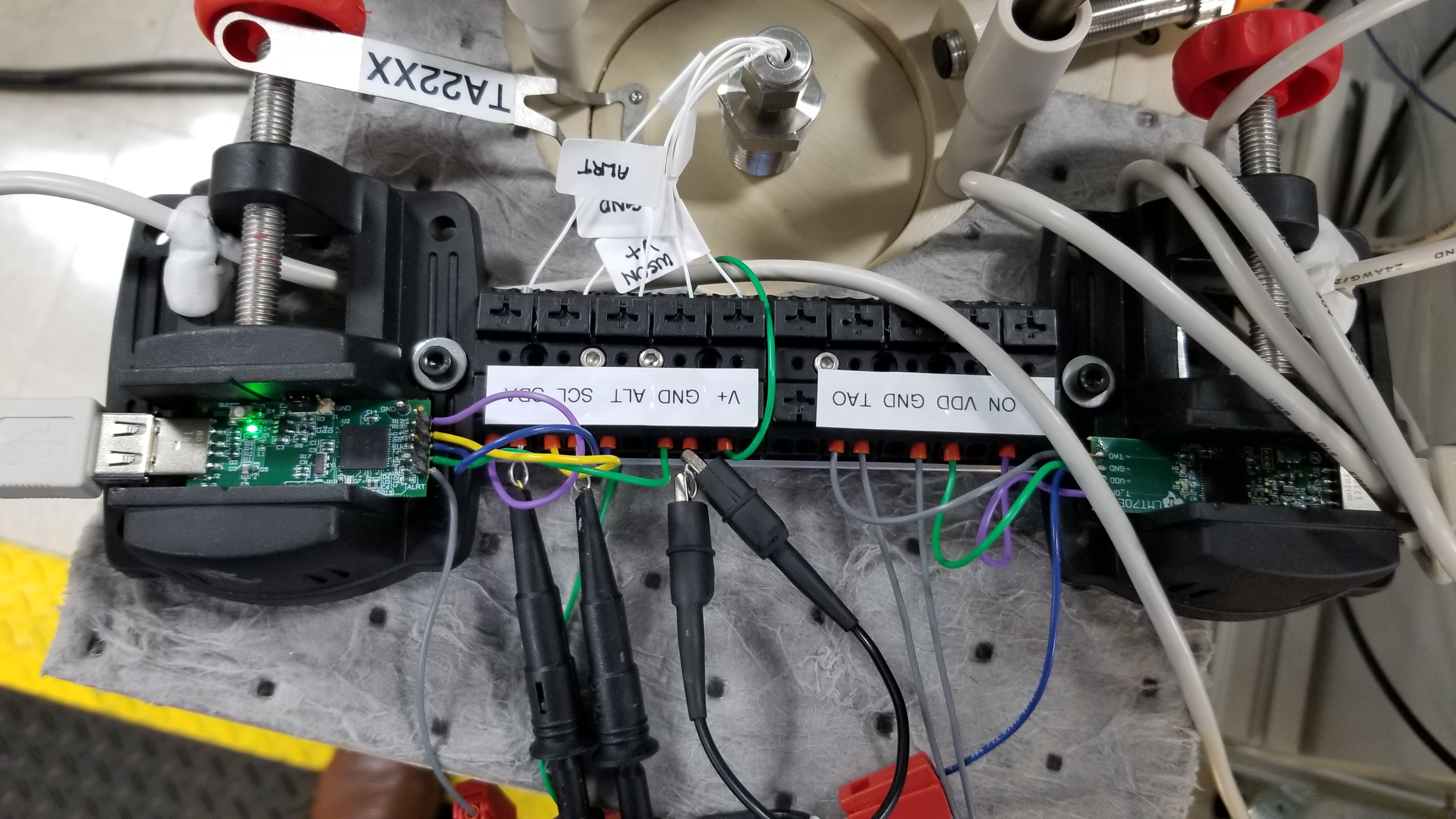

    My setup is shown below... (the EVM to the right is for your other product, LMT70 and is not powered up during this test).
    Any ideas on what could be causing this problem? It bugs me that the sensor works completely fine at room temperature.

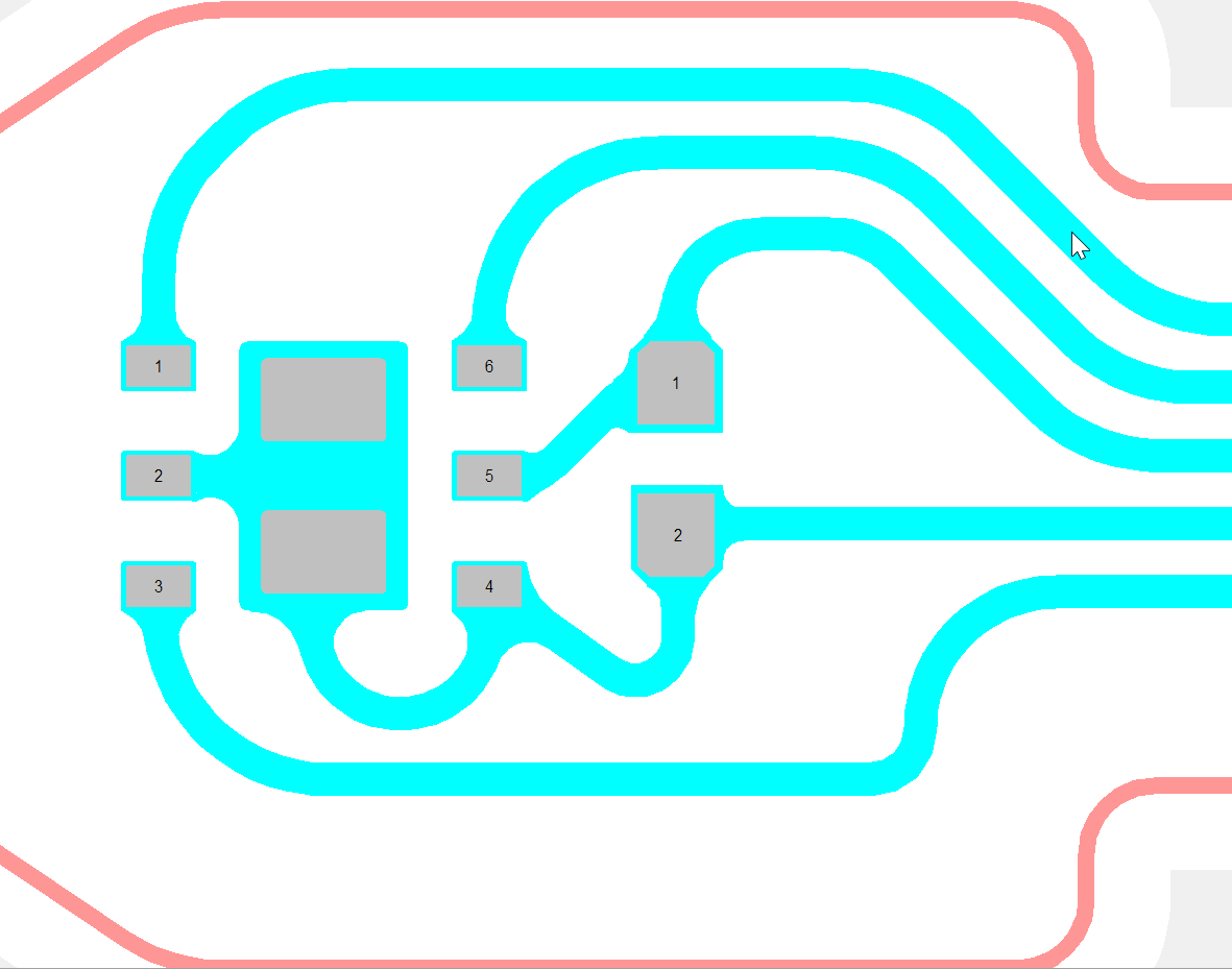

    It is interesting as you've said that the I2C "noise" had the same duration/ period as normal communication. We are also leaning into mechanical stress... below is our layout for the BGA package of the TMP117, track widths are 0.2mm. I have given it plenty of slack to compensate for any expansion/ contraction at higher/ colder temps.Just want to post it here and see if you see any red flags.
    It is also important to note that we don't have any underfill or glob topping material on these samples we've tested...
    /Ches
  • Hi Chester,
    The layout looks pretty clean to me; thanks for sharing. Having your SCL/SDA routed next to one another will cause the edges of each to appear on the other as a glitch. If possible, place a ground or supply trace between them. At any rate, this is not the cause of your issues, because it would take an extreme case of coupling to cause communication failure. The transaction would still be visible, but it would be interpreted incorrectly.
    Underfill or 'glob top' may exert stress on the temperature sensor causing a slight shift in temperature error. The errors we've observed due to package stress have been less than 0.1C, and could be calibrated out afterwards.
