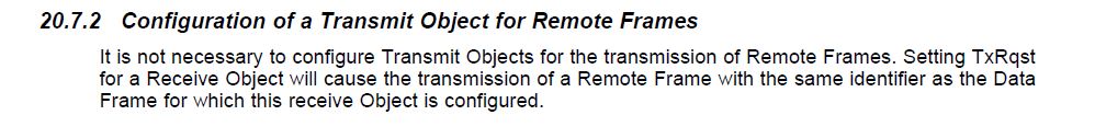

I am using AWR1642. While CAN protocol implementation, I want to send remote frame to get data when i want.
I set    txBuffElem.rtr =1; in canfd.c file.  on receiving side, i copied receiving rtr bit into variable and printed  .
It is printed as 0.    what should i change to send remote frame . please guide me.
