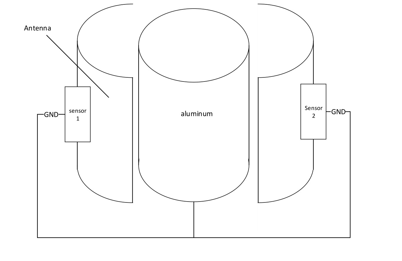

    Please have a look at our implementation.
    We place 2 FDC2214 sensors on both side of a cylinder made of aluminum. When only one sensor is activated, the data measured by the sensor is good, but when both sensors are activated, the data fluctuate intensely.
    Is it possible to add something between the sensors and the cylinder to mitigate the fluctuation of the data?

    You may be able to shield the sensors, but it would likely reduce your overall sensitivity. I highly recommend separating the sensor frequencies. The LC tank sensors are inherently narrow band-pass filters, so if their resonant frequencies are sufficiently separated they will not affect each other.
