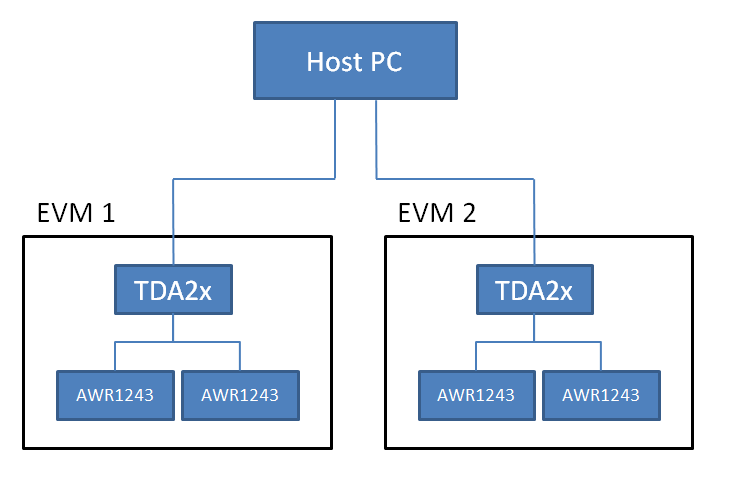

  • Hi Jitendra,
    Thanks for your comments.
    Please find an example block diagram.
    (1)    EVM1 and EVM2 are independent cascade setup. So I don’t need to sync these EVMs.
    (2)    However, I want to control both EVM1 and EVM2 from one host PC
    > You are right that existing mmWave Studio can control only one EVM. We are in the process of next version of mmWave Studio release which can connect to TDA2x+AWR1243P cascade setup over ethernet. Stay tuned to ti.com for the release announcement.
     Do you mean that more than 2 TDA2x+AWR1243P cascade setup can be connected to one mmWave Studio in next release?
    Thanks & Regards,
    -Shibata

    Next release version of mmWave Studio can control only one TDA2x over Ethernet not two.
    But based on you setup diagram, you can use different interface connection with TDA2x to connect and control 2 TDA2x (having 2-set of AWR1243P on it) from PC.
    You can control two TDA2x over UART which will be emulated over UART-to-USB to COM port of PC.Both of TDA2x will provide different COM port, so now you can send commands over UART to both of TDA2x which further control/configure AWR1243 devices.
    Another option to do over network connection (IP-address from single PC) instead of UART. Vision SDK provides default example for UART and Network connection.
    Jitendra
