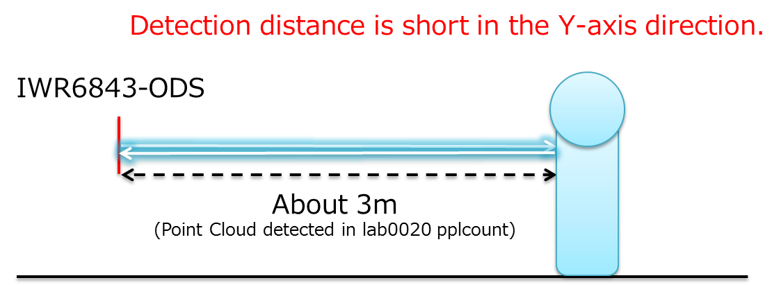

    You are exiting the FOV of the sensor. Antenna FOV is +-60 degrees - as you get past 3 or 4 meters, depending on mounting height, you generally fall out of the FOV.
    Justin

    I illust what we want.
    And, Saying 3m is when the radar is perpendicular to the floor.
    Best Regards.
  • Dear Justin
    Thank you for teaching me.
    By the way, is filtering 2.7m that you saying the part commented out below of source code?
    @C:\ti\mmwave_industrial_toolbox_{version}\labs\lab0020_pplcount_Overhead\src\dss\dss_data_path.c
       /* Compute (x,y,z) cordinates of the detected object */
        x = range*sin(theta)*cos(phi);
        y = range*cos(theta)*cos(phi);
        z = range*sin(phi);
    //    if (y > 0.5 && y < 2.7) {
    //        y = 1.5;
    //        range = sqrt(pow(x,2) + pow(z, 2) + pow(y,2));
    //        phi = asin(z/range);
    //        theta = asin(x/(range*cos(phi)));
            obj->outputDataToArm.outputToTracker.range[objIndex] = range;
            obj->outputDataToArm.outputToTracker.angle[objIndex] = theta;
            obj->outputDataToArm.outputToTracker.elev[objIndex] = phi;
            obj->outputDataToArm.outputToTracker.doppler[objIndex] = (float)obj->detObj2D[objIndex].dopplerIdx;
            obj->outputDataToArm.outputToTracker.snr[objIndex] = (float)obj->detObj2D[objIndex].peakVal;
    //    } else {
    //        obj->outputDataToArm.outputToTracker.range[objIndex] = 0;
    //        obj->outputDataToArm.outputToTracker.angle[objIndex] = 0;
    //        obj->outputDataToArm.outputToTracker.elev[objIndex] = 0;
    //        obj->outputDataToArm.outputToTracker.doppler[objIndex] = 0;
    //        obj->outputDataToArm.outputToTracker.snr[objIndex] = 0;
    Best Regards.
    That is correct.
    Justin
