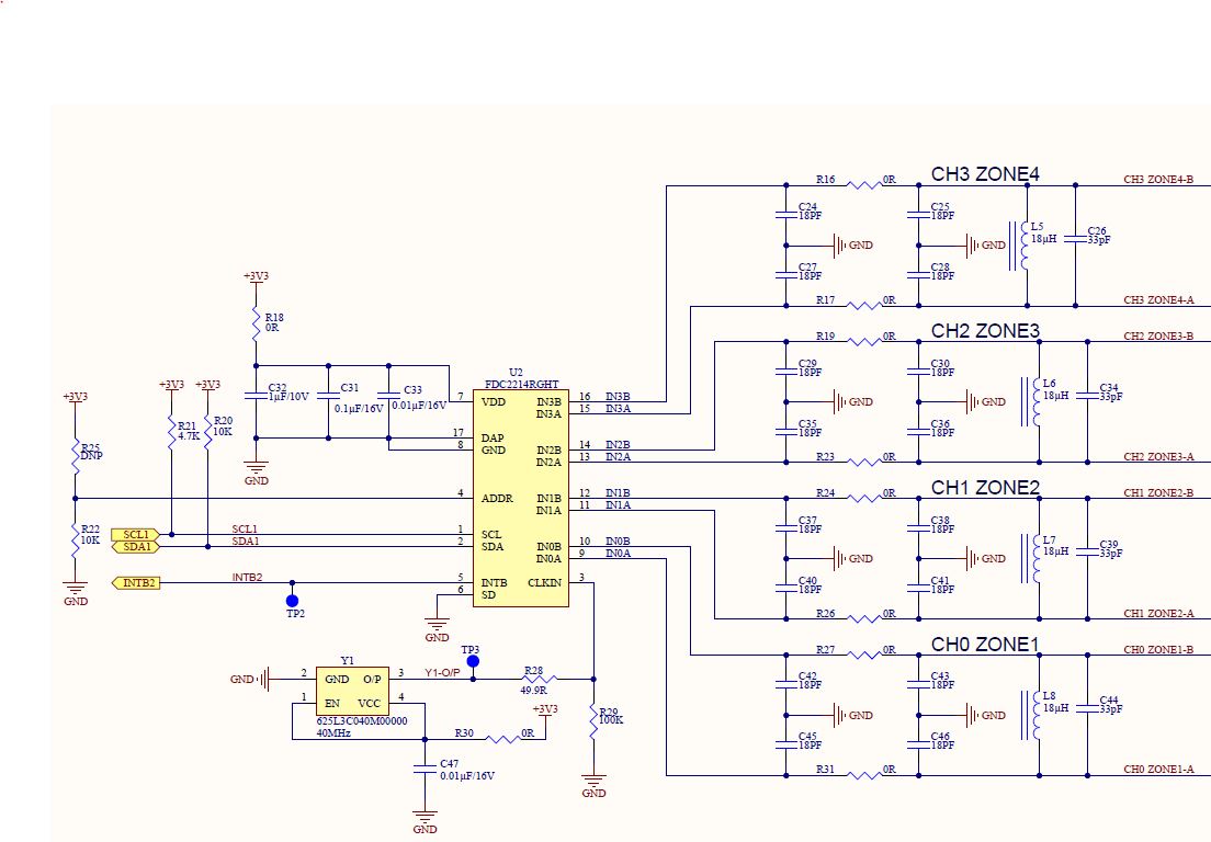

  • Hi Kristin
    Sorry for the delayed response.
    Please find the attached schematic.
    We have two no.s of the below circuit on board, for interfacing 8 capacitors in differential configuration.
    Vishnu
  • Hi Vishnu,
    Your schematic looks good to me. It may not be possible to find a single drive current to keep the oscillation amplitude amplitude within the ideal range for the full range of your sensor capacitance (though I strongly recommend this if possible). You may need to change your drive current as your sensor capacitance changes. Below 1.2V your SNR will reduce, and above 1.8V the ESD diodes can turn on and reduce your measurement accuracy.

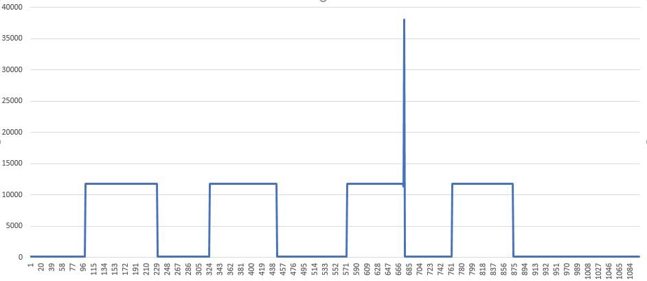

    I tried to test the IC with fixed capacitor values - maximum 10nF. I connected a toggle switch in series with 10nF on 1 channel and connected fixed values on all other. Please see the below plot of capacitance vs no. of samples in the channel on which i have connected switch.
    I have observed the below overshoot, which was not repeatable . Also, i could find at times the capacitance drops to zero at irregular intervals after the transition to 10nF (i will share an image of it).  Does this occur due to the instability of the tank circuit? Is there any upper limit on the capacitance that can be connected for a particular inductor value or drive current? i could find from the datasheet that the IC can sense upto 250nF, with an inductor value of 1mH.
    I'm not sure of it as both these cases were not regular or repeatable.
    Vishnu
  • Hello Vishnu,
    There is definitely an upper limit to the sensor capacitance for a given inductor value. I recommend reading section 1.2 of LDC Sensor Design. Though the application note is primarily useful for inductive sensing, section 1.2 describes Rp of an LC tank sensor, which is used by both the FDC2xxx devices and the LDC devices. As the capacitance of your sensor changes, the Rp value will also change, which changes the oscillation amplitude of your sensor. I suggest measuring the oscillation amplitude at both the minimum and maximum sensor capacitances to verify that it is within the optimal range.
    These spikes can sometimes occur if the oscillation amplitude is out of range. Sometimes spikes like the one shown in your second image can be caused by EMI, so I recommend using the filter capacitors shown in the FDC2214EVM schematic.
