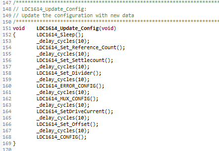

I am new in this field. As i have been working for a lot of days to read data from LDC1614EVM using MSP430 MCU by I2C protocol communication.
Actually now i am able to configure my LDC1614 EVM according to the example found in the datasheet. but my problem is while reading back some registers as the Status Register i always found that DRDY bit is always cleared and due to this condition i am not able to get data from my EVM. I have attached my initialization steps so that you can help me if there is a problem through this.
So please can you help me to find an answer for my question.

  • Hello Sherif,
    In order for the DRDY bit to update in the STATUS register, you need to have the DRDY_2INT bit set to 1 in the ERROR_CONFIG register. Is this set?
    Can you read back your register setting for MUX_CONFIG? You should have the AUTOSCAN_EN bit set to 0 and then select the active channel in the ACTIVE_CHAN field in the CONFIG register. It sounds like you have continuous conversion mode disabled, which defaults to measuring both channel 0 and channel 1.
