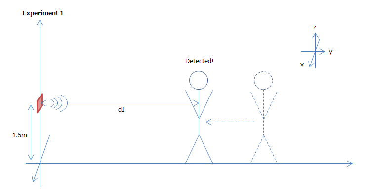

[Experiment 1]
- Device
IWR6843ISK-ODS
- FW
"C:\ti\mmwave_industrial_toolbox_3_6_1__win\mmwave_industrial_toolbox_3_6_1\labs\lab0020_pplcount_Overhead\Pre-compiled Binary\ODS\ods_pplcount_lab_68xx.bin"
- configuration file
"C:\ti\mmwave_industrial_toolbox_3_6_1__win\mmwave_industrial_toolbox_3_6_1\labs\lab0020_pplcount_Overhead\GUI_A_base_no_logic\mmw_pplcount_demo_default.cfg"
- radar mount position
(see below)
- How I measured
I ran matlab app in SideMount mode and measured d1 where points(not target tracks) started to appear.
matlab app: "C:\ti\mmwave_industrial_toolbox_3_6_1__win\mmwave_industrial_toolbox_3_6_1\labs\lab0020_pplcount_Overhead\GUI_A_base_no_logic\main_pplcount_viz.m"
- result
d1 = 3.5m

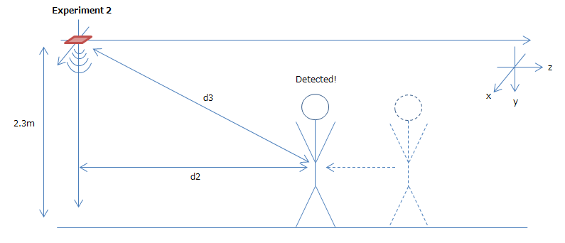

[Experiment 2]
- Device
Same as Experiment 1.
- FW
(see below)
- How I measured
I ran the same matlab app in Overhead mode and measured d2 where points(not target tracks) started to appear.
- result
d2 = 5.5m -> (d3 would be calculated as 6~7m geometrically.)

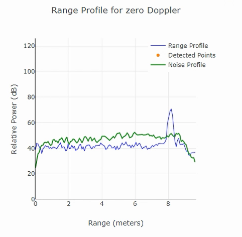

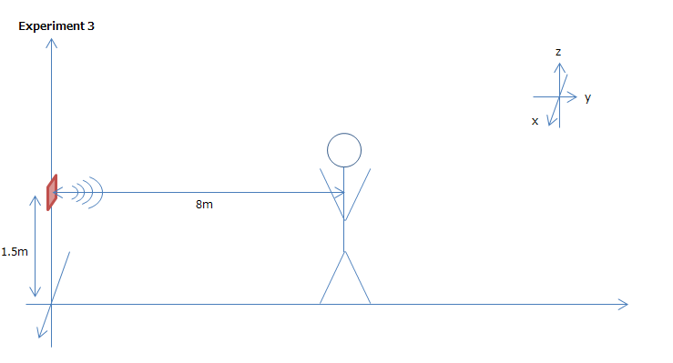

    I also did the experiment 3 as below and checked if a person past 3.5m can be detected in range profile level.
    [Experiment 3]
    - Device
    - FW
    "C:\ti\mmwave_sdk_03_01_01_02\packages\ti\demo\xwr68xx\mmw\xwr68xx_mmw_demo.bin"
    (see attached file)
    profile_rangeProfile_lab0020_default.cfg
    I set the parameters so that profileCfg and frameCfg will be same as those of people count demo.
    (see below)
    - How I measured.
    I ran mmWave Demo Visualizer 3.2.0 and captured range profile screen shot when I was standing at 8m away from radar.
    - result
    (see below)
    According to the experiment 3 result, it seems to be possible to detect a person at 8m away from radar in y-direction.
