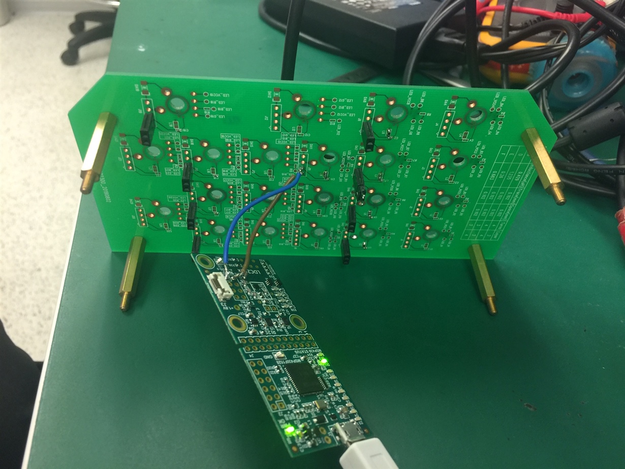

Hi Sir,

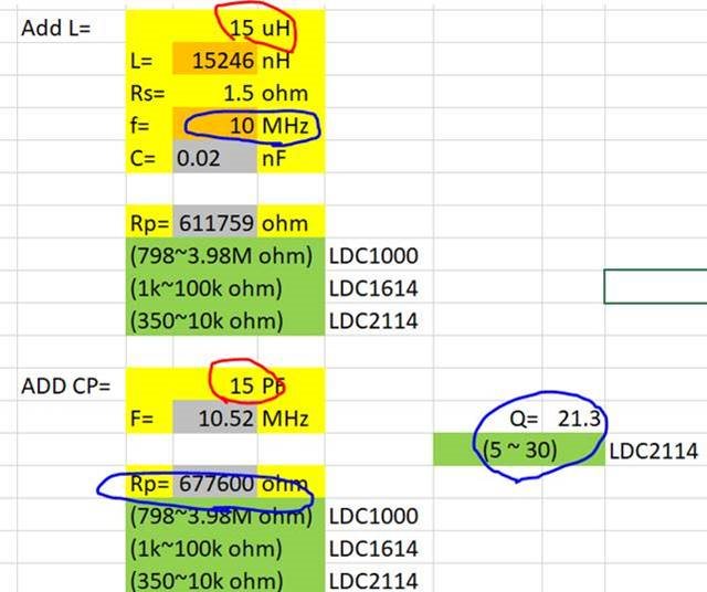

We uses LDC2114 EVM and setup: L=15uH (MLZ2012M150W), C=15pF (NPO)
These values will:
fsensor=10MHzèok
Q=21.3èok
Rp=612Kè over spec (350~10K ohm)
But it looks not working on EVM, would you pls advise how we can let EVM working formal?
Thanks, Ian.
  • Hello Ian,
    That sensor Rp value is far too high for the LDC2114 to effectively drive. To solve this, your customer can add series resistance or increase the capacitance value until the Rp value is below 10kohms.
  • Hub jones,
    Do you have suggest L. C value for trying? It’s hard to meet three conditions, thanks.
    Thanks, Ian.
  • Hi Ian,
    The values used in the calculations above don't match the actual L and Rs values of Coil N in the LDCCOILEVM. You can find the actual values in this document: http://www.ti.com/lit/ug/snou136/snou136.pdf. That coil's inductance is only ~0.25uH, depending on the sensor frequency. With a 15pF sensor capacitor the resonant frequency is roughly 80MHz. The maximum sensor frequency that the LDC2114 can drive is 30MHz. Try using 150pF or greater instead of 15pF for the sensor capacitor.

    But for my customer's keyboard coil, seems still need to fine tune.

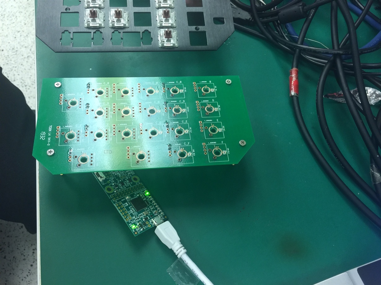

    Customer's keyboard (E-Coil, 0.26uF) with L=0uH & C=680pF
    These values will change:
    fsensor=11.97MHzèok
    Q=0.9 - over spec (5~30)
    Rp=539 - ok (350~10K ohm)
    Remove metal sheet, use finger touch is fine but with bottom will not good, would you pls advise what we can fine tune?
    Thanks, Ian.

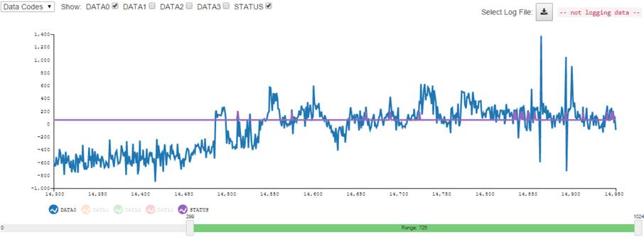

  • Thanks for information, Q close to 30 is correct. EVM can work fine with LDCCOILEVM (N-Coil).

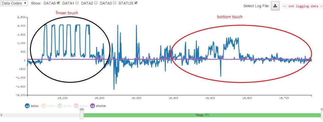

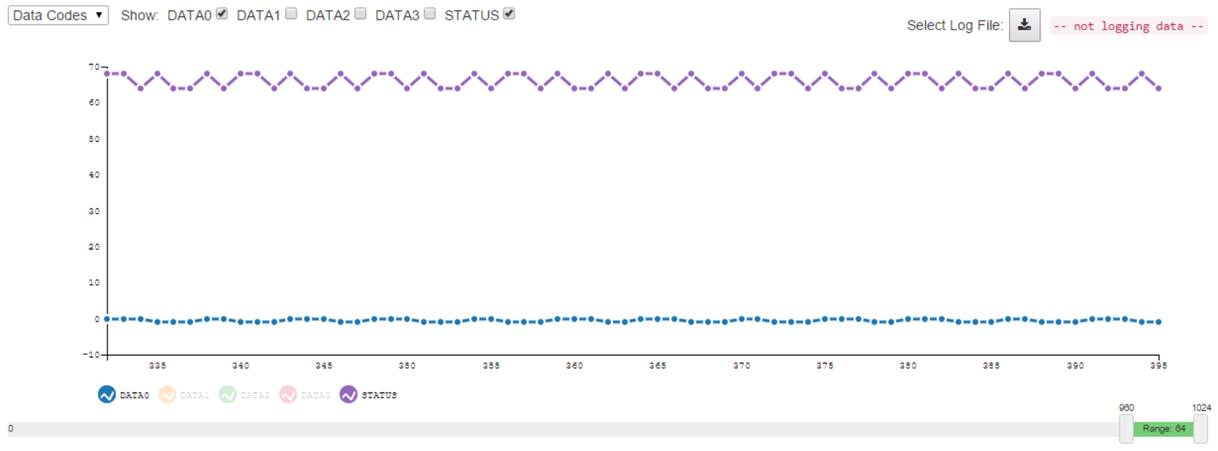

    Now, we change to using customer's coil and set as below,
    It works fine when using finger touch, pls see left black block as below picture,
    But when we have bottom upon coil, it works bad as right red block in above picture,
    Pls advise how can we fine tune to let it work fine using bottom?
    Thanks, Ian.

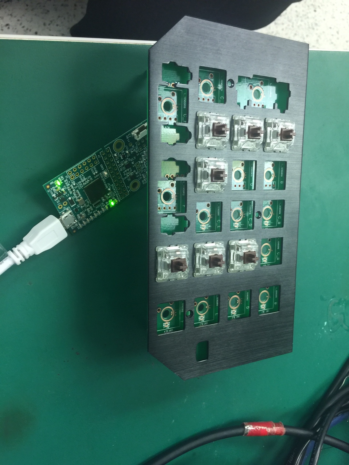

    The end customer is H customer, application is gaming keyboard, H push us hard and we need your help.
    Thanks, Ian.
  • Hi Ian,
    It looks like the coil's Rp is too low. The calculator tool shows that the Rp value is 350 ohms, which is the minimum Rp value that the LDC2114 can effectively drive. The calculator tool can sometimes differ from the physical values, so it's possible that the sensor's Rp is too low. Although the bottom plate looks like it is recessed enough away from the coils, it's possible that it is slightly reducing the Rp value, which makes it even harder for the LDC2114 to drive effectively.
    I do recommend measuring the actual Rp value of the customer's coil using one of these methods.
    If the Rp value is too low, a quick fix is to reduce the sensor capacitance value. Also please note that parasitic PCB capacitance and the input capacitance on CINx (typically 15pF) will also affect both the sensor oscillation frequency and the Rp value. This additional capacitance would further reduce Rp.

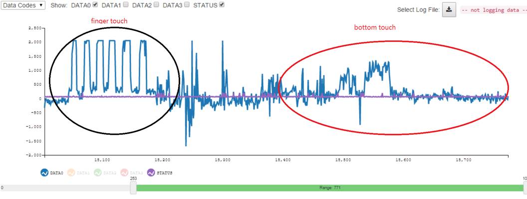

  • Hi Jones,
    We increase Rp but look like not have huge improve.
    If possible you can help tuning it for us with real bottom/PCB?
    Thanks, Ian.

  • Hi Jones,
    I follow your comments increase Rp to 740 ohms, looks similar result, it's not working with bottom touch.
    Do you have others suggest?
