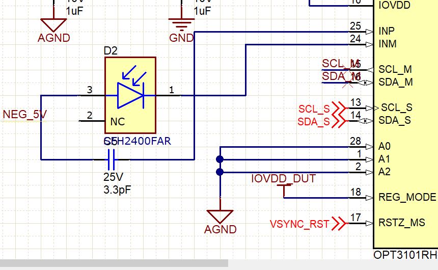

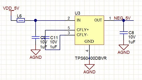

    Okay. If you like, please send me your layout and design before building the boards and I will check them to make sure if you do a redesign it will perform well. Also we have an update to the design guidelines to further reduce crosstalk which using a -5V as PD ground. Please refer to the screenshots below.
    Also what was the crosstalk level measured in your current PCB design?
