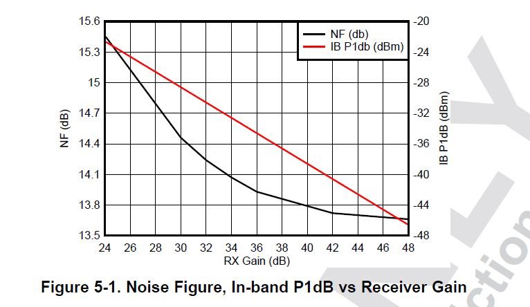

  • Hello Rata,
    Your understanding is correct regarding the RF and IF gain.
    Higher gain typically provides better noise figure but the P1dB compression will be poorer. So its a trade off based on your use case. Below is a plot that indicates this trade off across gain settings. Beyond 40db Rx gain the improvement in noise figure is very minimal.
    vivek
  • Hi vivek,
         Thanks for your reply,you said 'Below is a plot that indicates this trade off across gain settings.', but I can not see it, can you show it again?
    Rata
  • Hello Rata,
    Sorry, looks like image did not get attached. Trying it again.
    vivek
