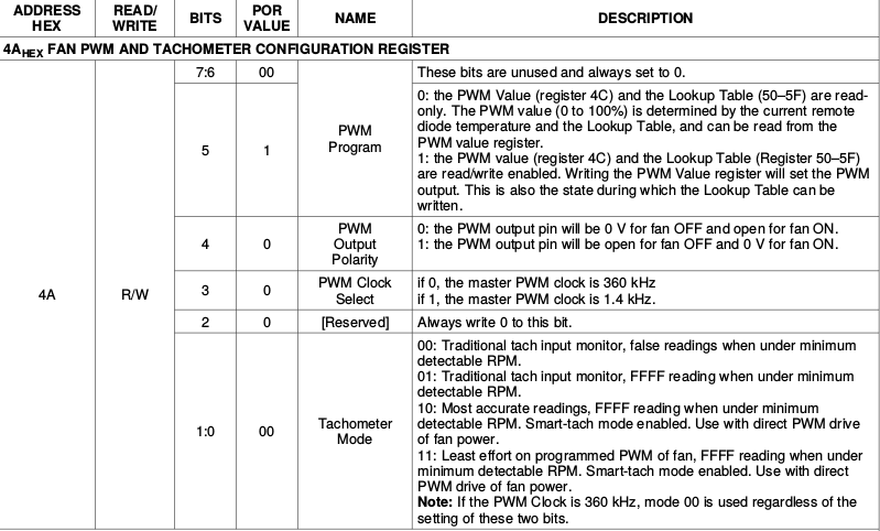

From LM63 datasheet show "Note: If the PWM Clock is 360 kHz, mode 00 is used regardless of the setting of these two bits." it's mean register "4A" bit 3 set to "0" the Tachometer Mode can't use "10" and "11" mode? What is the working principle of Smart-tach mode? If my fan PWM frequency is 25kHz, how can I do the Lookup table to control the fan speed?
    You are correct, when using 360kHz mode the Tachometer mode will function as mode 00.
    Smart-tach measurement accommodates for the corrupted tachometer pulses when using switching transistor drive.

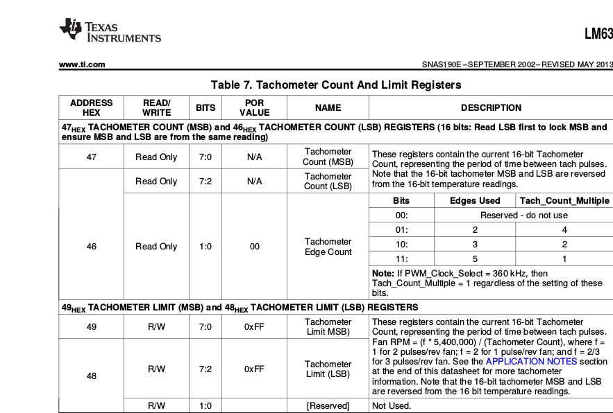

    1) what does it means about "Tach_Count_Multiple" and "Edges Used" on register 0x46 on pp25 of datasheet? how to apply these parameters to RPM calculation?
    Please see "COMPUTING RPM OF THE FAN FROM THE TACH COUNT" on page 30 on how to calculate RPM.

  • Hi David,
        The "Edges Used" bits are defined in register 0x46 on page 25.
        Since these two bits are read only, does it mean that the "Edges Used" and "Tach_Count_Multiple" fields are automatically set by the LM63 chip?
        Besides, the example of computing RPM on page 30 uses the value of register 0x46 as the LSB in calculating the Total_Tach_Count. Bit 0 and bit 1 aren't masked off in the calculation, and it seems that the "Edges Used" and "Tach_Count_Multiple" bits are used in the RPM calculation.

  • Hi Todd,
    You are correct; these bits are used to represent the RPM and to indicate how the LM63 calculates the RPM. The "Edges Used" bit indicates how many edges the LM63 detected and used when calculating the RPM. The "Tach Count Multiple" bit indicates the multiplier the LM63 used to calculate the RPM.
    The Tach mode set in 0x4A <1:0> determines when the Tach monitor will detect the edges of the tach input.
    Mode 00: The Tach monitor is on regardless of its corresponding PWM.
    Mode 01: The Tach monitor is on only when its corresponding PWM is high.
    Modes 10 and 11: The Tach monitor is on only when its corresponding PWM is high. The PWM high time will be extended up to 50ms to allow enough time to calculate the fan speed.
    For example, if the LM63 only detects 2 edges the LM63 multiplies this time period by a factor of 4. This results in the Bits [1:0] of Register 46hex to be set to 01 [Edges Used = 2, Tach_Count_Multiple = 4].
    If only 3 edges are detected, then the LM63 multiplies this time period by a factor of 2. This results in the Bits [1:0] of Register 46hex to be set to 10 [Edges Used = 3, Tach_Count_Multiple = 2].
    If 5 edges are detected, then the LM63 multiplies this time period by a factor of 1. This results in the Bits [1:0] of Register 46hex to be set to 11 [Edges Used = 5, Tach_Count_Multiple = 1].

  • Hi David,
        Thanks for your information. However, the description of the register 0x4A <1:0> on page 21 is somewhat different from what you mentioned. The datasheet doesn't mention that modes 01, 10, and 11 are used only when its corresponding PWM value is high. Besides, what does the "Smart-tach mode" mean for mode 10 or 11? What does "Use with direct PWM drive of fan power" mean for mode 10 or 11?
        Regarding to the "Edges Used" and "Tach_Count_Multiple" information, it seems your diagrams are targeting for capturing pulse edges in the time interval of two pulses. Is this rule applied for fans with 2 pulses/rev? Or it is applied to all fans? Since we set PWM_Clock_Select to 360 kHz, the Tach_Count_Multiple is fixed to 1 according to the datasheet. Does it mean bit 0 of register 0x46 will always be fixed to 1? Or we need to forcefully set this bit to 1 RPM calculation? By the way, how to interpret the "Edges Used" bit when setting PWM_Clock_Select to 1?

  • Hi Todd,
    Please see above reply on Smart-tach mode.
    "Smart-tach measurement accommodates for the corrupted tachometer pulses when using switching transistor drive"
    Direct PWM drive of fan power is the use case where the PWM directly involves turning the fan's power supply on and off typically by controlling a MOSFET. Please see Figure 3 for an example.
    This applies to all fans. Please see "COMPUTING RPM OF THE FAN FROM THE TACH COUNT" section of the datasheet to determine RPM if not using a 2-pulse/rev fan.
    This will be fixed to 1 when PWM_Clock_Select is set to 360 kHz.
    No change in interpretation. When PWM_Clock_Select is set to 360 kHz the number edges used will be 5.
