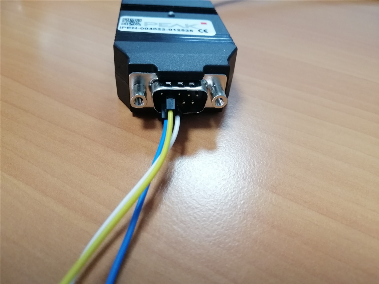

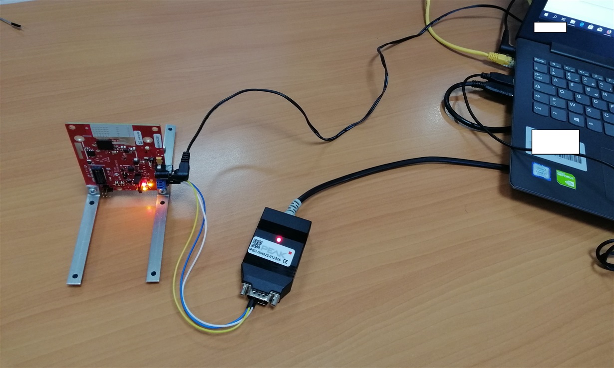

I flashed the kit with  xwr16xx_odoc_ti_design_lab which is located in lab0005_object_data_over_can folder then I followed all instructions listed in the userguide.
The final setup is as follow:

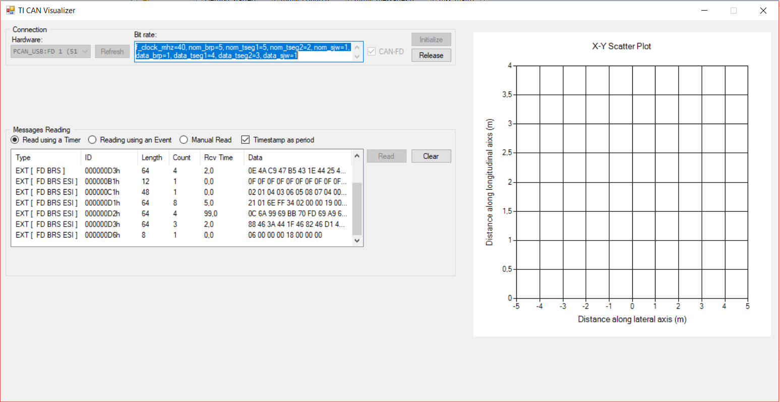

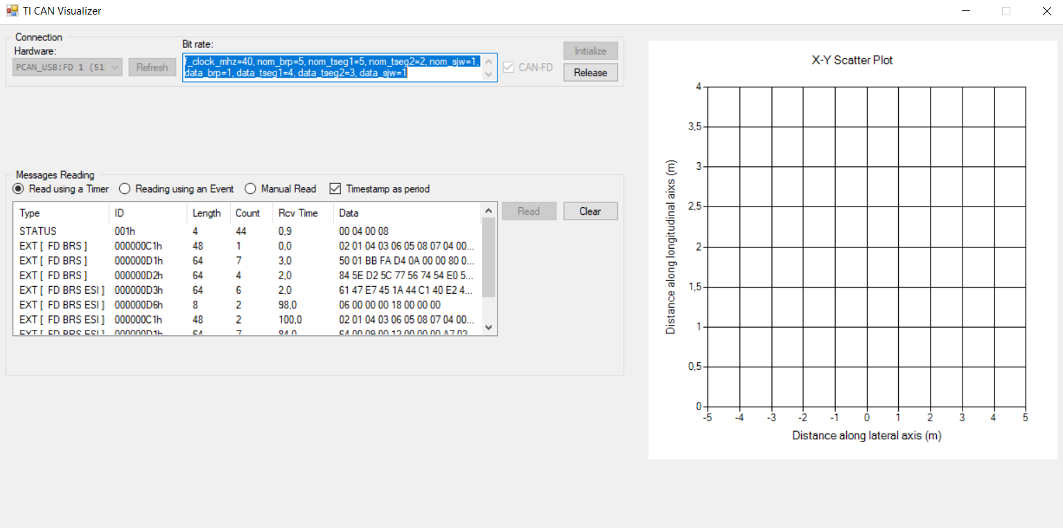

Then I launched the visualization application MMWAVECANVISUALIZER and I got results shown on the bellow picture:
As you can see on X-Y scatter plot the RADAR has not detected objects and it stoped sending frames (messages) through CAN BUS. when I clic on release button then I clic on inisialize nothing appear in message reading table and the same for X-Y scatter plot.
How can I resolve this issue
